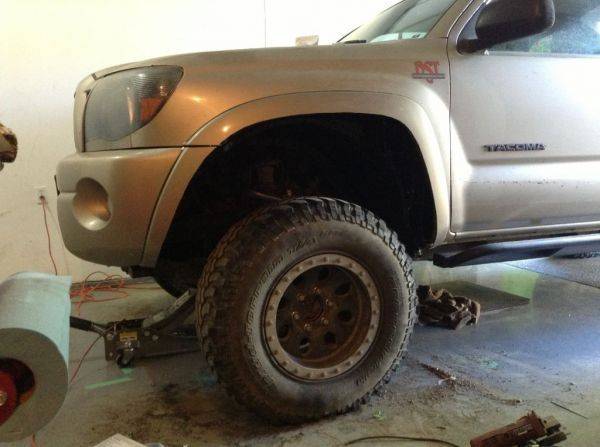

    Thanks zbaldo
    Na, not yet. Cut the fenders today, so much room now. Trying to line up a deal for 35's, have a set of Duratrac's for a smokn deal but would still like a mud tire.
    Next to do is cut and build my leaf pack then install a shackle flip, doing the 6'' trail gear shackle. Want to see how much lift that gives before doing the shock relocate, might try to get a 13'' shock made up or see if a 14 will fit, doubtful tho.

    Thanks Gramps, wasn't too difficult, just time consuming.
    Broke a bunch of fender clips taking them off. Went to Toyota, I know the parts guy well :cool: He pretty much didn't want to give me a price for a good reason, $1.89ea for the blue and $5.50 ea for red :eek:
    Ordered a bunch of Amazon but still cost $30 #2ndgenproblems :D

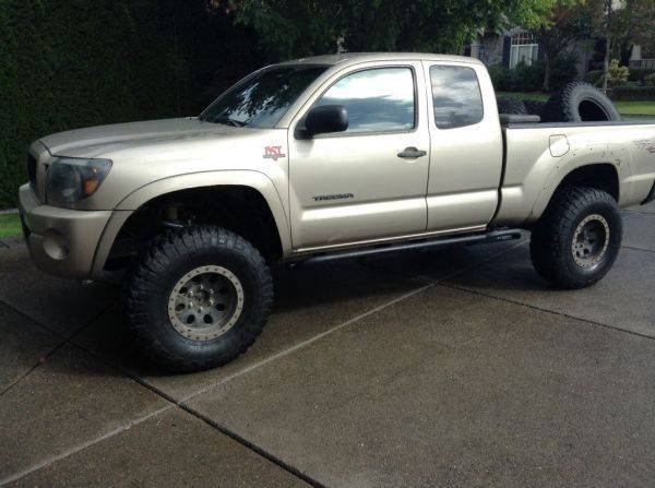

    35's are on :woot:

    Sweet! Yeah I got to practice the fender trim on NYCO's truck in my garage. Got a handle on things for when I do mine. Tips we learned doing this were:
    • Buy a bag of clips online (as you did)
    • We added in bolts and wing nuts on the ends of the plastic fenders in place of the clip to insure a sold hold.
    • An electric Sheet metal cutter(HF) cuts the fender very smoothly and very nicely. :D
    • Patent Pending measurement tool coming out soon... :spy:

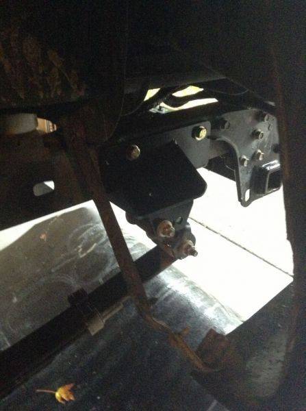

    Shackle flip installed and burned on a flowmaster 40 last weekend. Finally got some nice rear rake back. Gota get some brake lines and shocks then flex the shit out of it :cool:

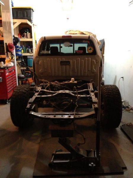

    Couple old pics
