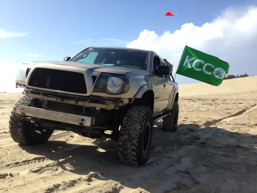

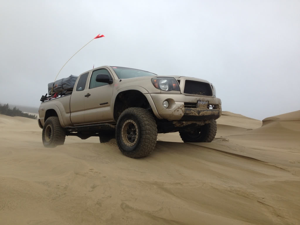

    Teaser
    ca7483c38d90e051ad5a0d3dfba49cbb_zpsb507_2cf50f80a57c3a2651ee3ce07e1a3359303f07d2.jpg
    a950bda141ae8720e12ead5a642a98ce_zpsdc54_b3d84204d974f70fac7871c1ad13d6a489117a43.jpg
    Lots more to come

    someone steal your bumper? lol
    sick pics !!!!

    How was the tent don?
  10. Mar 31, 2014 at 8:48 AM
    #110

    The sand stole my bumper :p rad got bent good too and muffler fell off. Barried the bumper up to the grill a couple times. Got air of some dunes pushed the mid travel pretty hard.

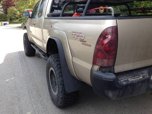

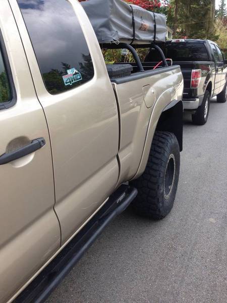

    Thanks guys. Gota post some pics still. Got everything fixed and wet okoles installed last couple days.

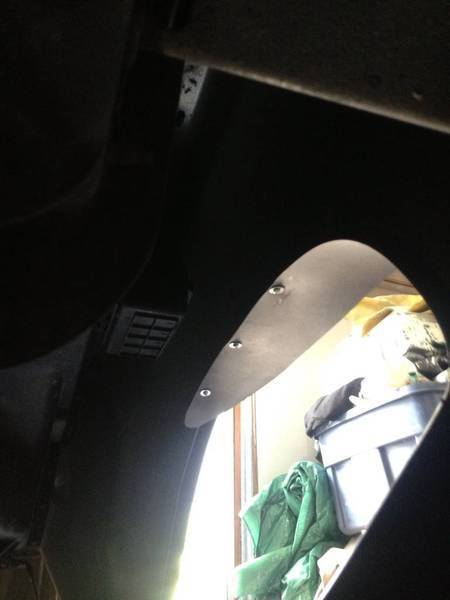

    Lookin good man!! When you making the write up of the fender flares?

    Write up for the fender flair mud laps I installed, thanks to geodesix.
