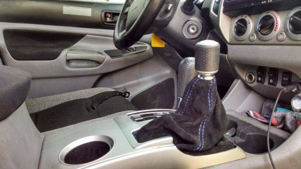

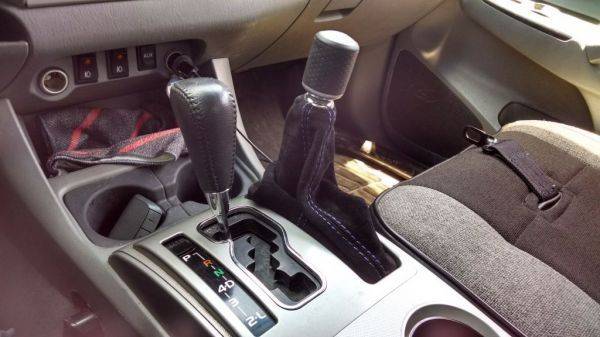

    I'm running just the single stick on my conversion. You have 2lo, 4hi, N and 4lo with just the single stick also. The twin sticks have a smaller footprint than the single J shift pattern, which would be nice but I'm happy with how mine turned out.

    He was running a j shifter, now he is running twins. Essentially yes its just for 2lo and true neutral.

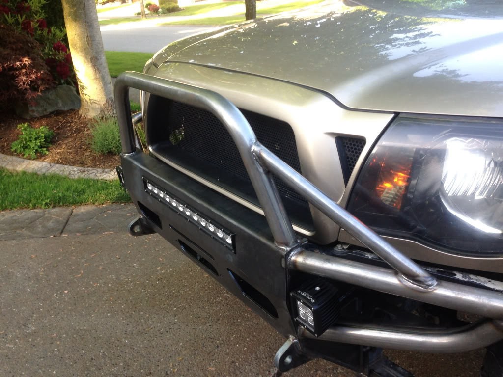

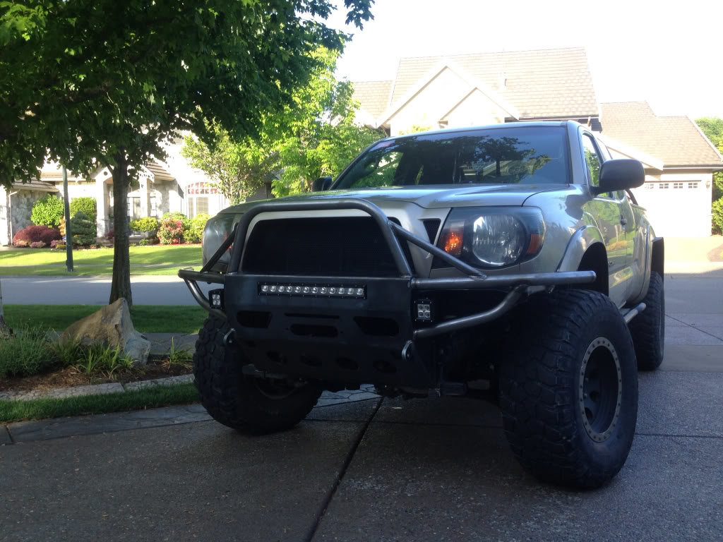

    Damn lembowski how did you get the j stick to fit in the consel and still have 4lo? I tried forever and couldn't make it work, I thought it had too much throw side to side.
    I guess I should post the new edition up :cool:
    5a0da032d68834e7f7667bfa692e0f3b_zpsd52b_c48604a02134e4304fadb9f1f51c181792e6f1b7.jpg
    72bbd6bdd36547859afcf45aebb5fe8d_zps78ce_9c2011e83b6d788f4a53b6e117e3b0757038055a.jpg
    Billy outdid himself on this. it sits a little high but looks good like that. Painting it tomorrow and it should be on.

    Billy builds some bad ass bumpers. That looks awesome on a tan truck!

    I tried for a billy bumper a couple years ago and said he couldnt ship to me :(
    Looks freaking bad ass man

    Took a lot of trial and error. Yes 4lo goes in fine, if the throw was an inch longer that wouldn't be the case lol. We had a days worth of different lengths/angles of the flat stock coming off the shifter. When in 2hi the auto shift just barely clears the TC coming out of park giving the maximum amount of room to swing into 4lo.

    Cool I like it very factory looking and didnt loose any cup holders :D
    Bumpers on and painted. Need to install winch, welding up Relentless rear next and getting skids made up in couple weeks. Ill probably do fibreglass fenders soon as well.
