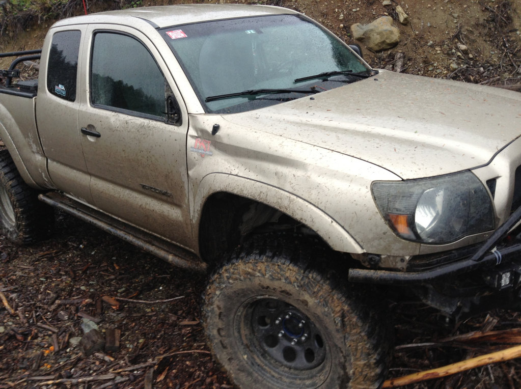

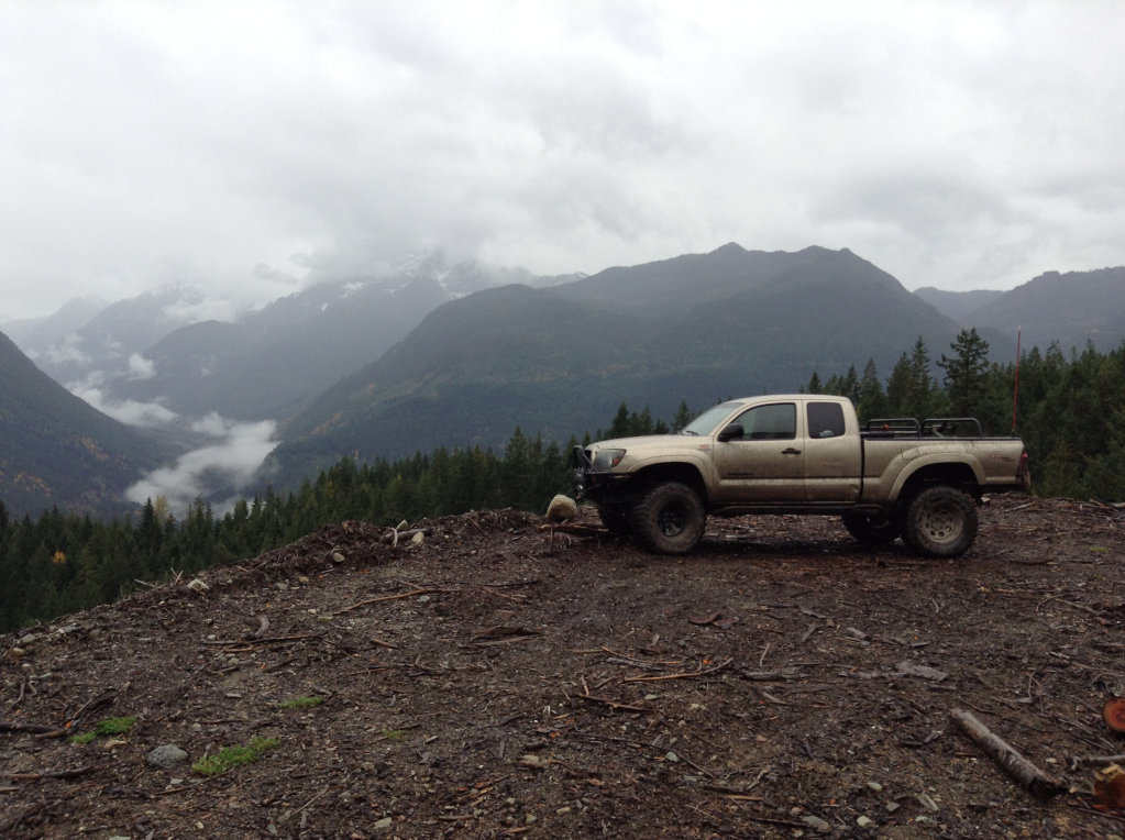

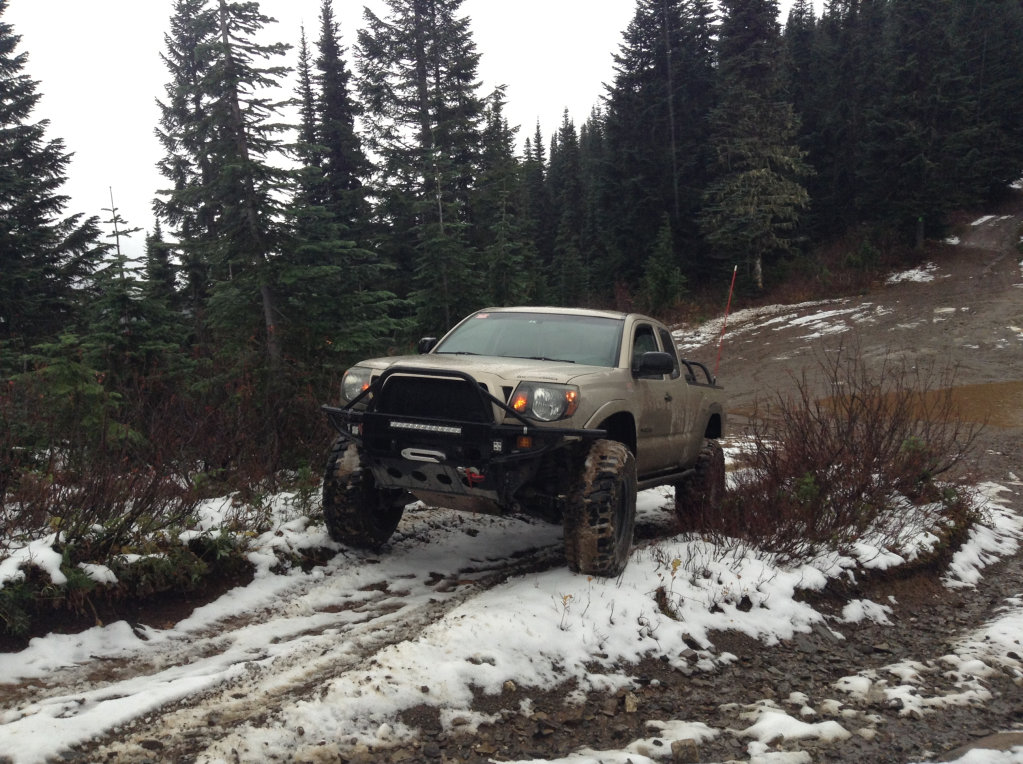

    Hit a tree going on quad trail, installed a new mirror got ripped off
    e48d6fe3077f412f07109b93c6aae942_zpsf354_1ee5dfe9a02ef69afca86d0528f2f2f9ab7c2da2.jpg
    Going to throw fibreglass fenders on and new headlights all the mounts are broken
    Got a deal on a 50" light bar, orange and white will install that soon

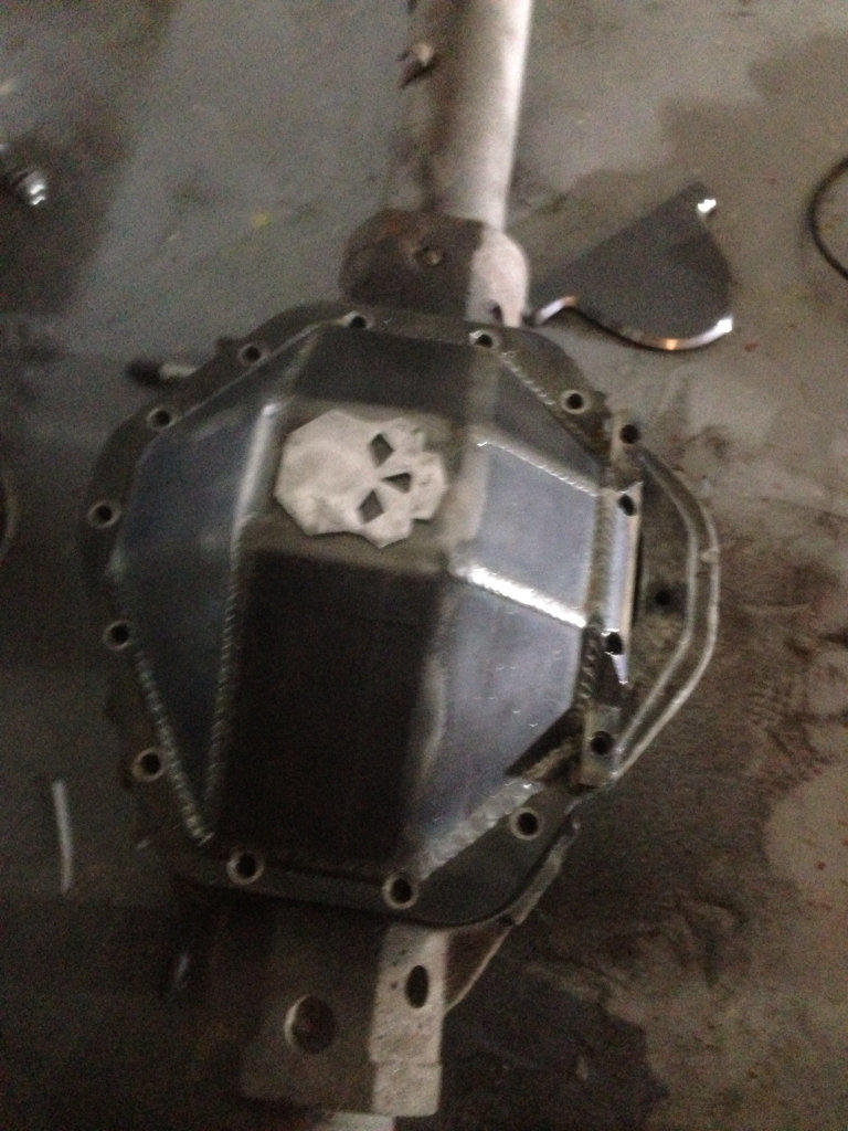

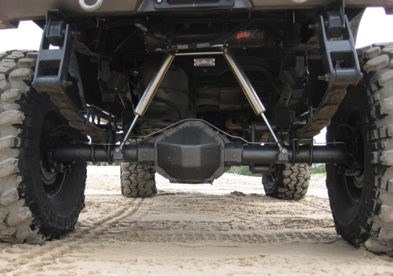

    Started working on 14 bolt, Balistic shave, Going to look like this when done

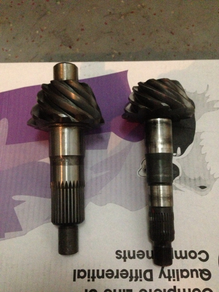

    Project Prerunner to crawler is a go

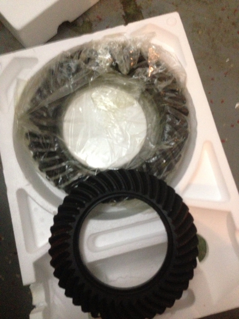

    14 bolt build is going hubs, rotors, axle shafts, ring gear is out for machining. 8 lug hubs getting machined down and redrilled for 6x5.5 and fit chev 12" disk rotors.
    Gota figure out the calipers and mounts, finish cutting shave then burn that in with the spring and shock mounts. Just need few more things and the Arb locker
    4.56 Yukon 10.5" vs 3.73 8" toy

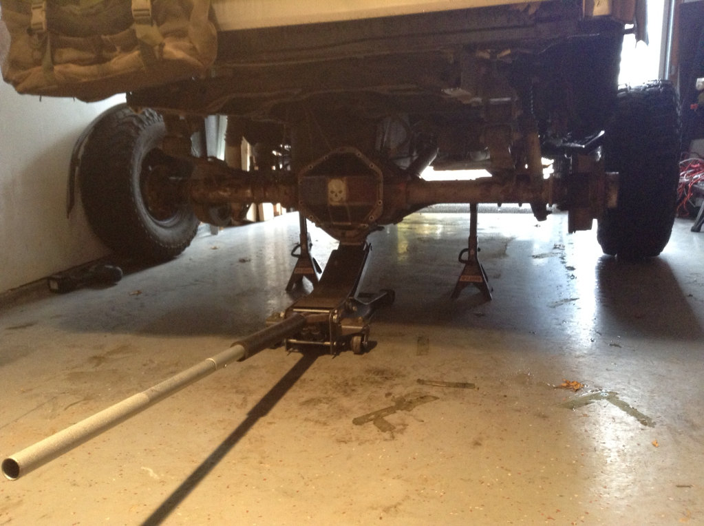

    Yea this will work :cool:

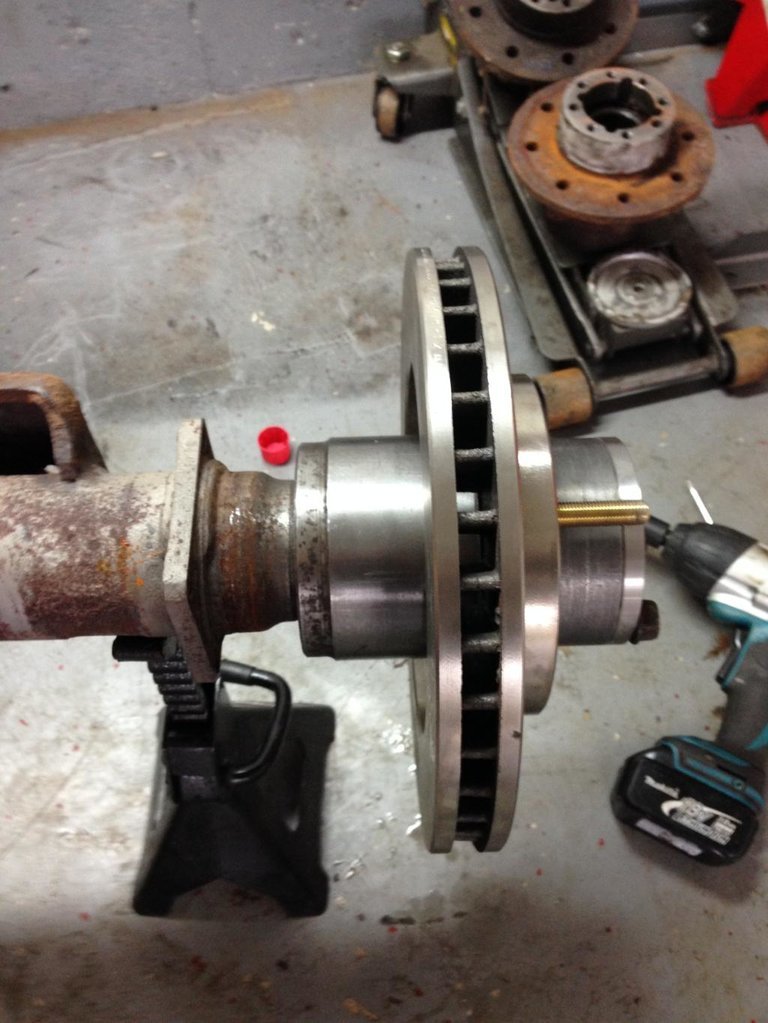

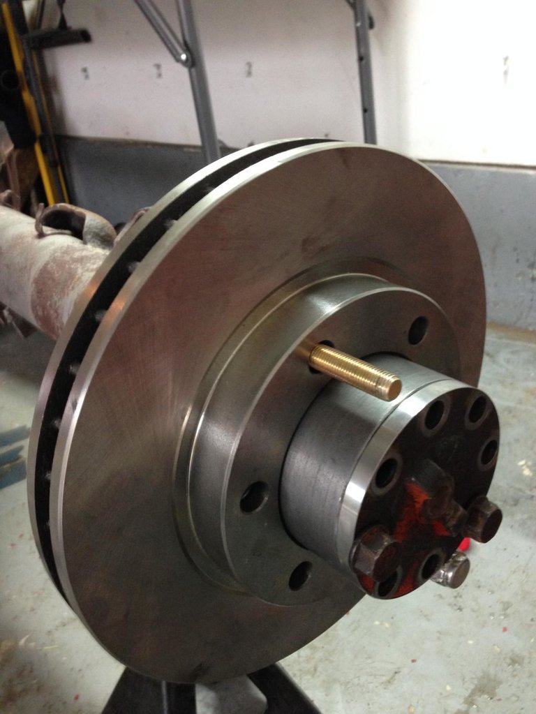

    Here's the custom hubs and rotors I had made up, srw 8 bolt hubs shaved down, plug welded and redrilled for 6x5.5, ARP studs with chev 1/2 rotors so they slip on the front as opposed to the stock and aftermarket way of pressing on the back. Have to modify ruff stuff caliper brackets, stoked on how it turned out.
