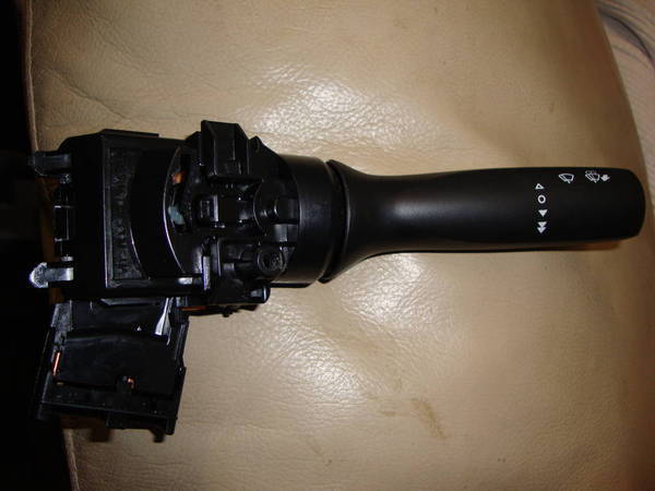

    Should be the same. Remove the wiper switch, and take all sorts of pics of it, including the connections, and post them here to clarify that the connections are the same. Best I can do for you is a pic of mine off a 2010 that I replaced with an intermittent.

    I have a '13 base and installed switch # 84652-04141...works fine.
    Also...the Yaris sedan and Taco share the same switch, except that the Yaris comes standard with a 3-speed switch (lo, high and fixed intermittent of about 3 seconds). You might be able to find one a little cheaper than the switch I listed above. I sold one to a member here for $40. It might not have the variable intermittent feature, but he was happy to have that extra speed.
