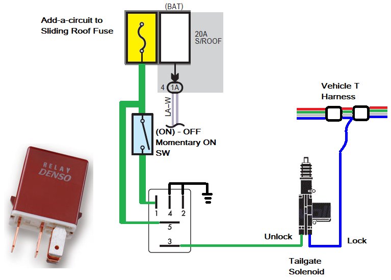

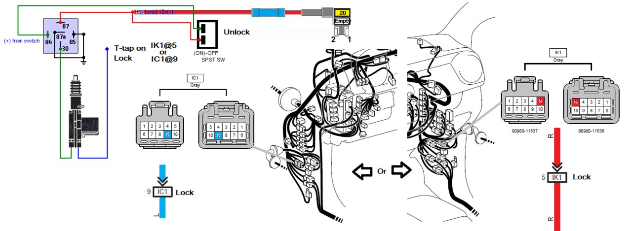

    Another simple one:
    Momentary ON to OFF switch for unlocking- other solenoid wire t-tapped into Driver's side Lock. You get unlock by individual switch, but to lock you lock all doors and tailgate...might not be what you'd like...
    another shot of same idea...maybe more clear
