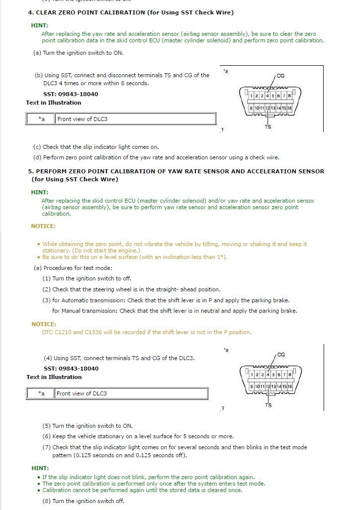

    Had the same issue! took my truck for alignment at Sears. As I drove away had the same light came on! I took it back and they didn't know what to do. Debating whether I should try this or take it to Toyota for warranty? :( Is the VSC calibration procedure attached for the 3rd gen? I'm thinking about trying this out tomorrow to save myself a trip to the dealer. thanks!

    Just used this thread 10 min ago, dealer wanted $160 to run a diagnostic on an already fixed alignment. Worked great just remember the picture port is upside down. Its 4 holes in from the right not the left. 2016 TRD Sport, no issues.

    If recalibration doesn't work, like it didn't for me, I was able to check the code to point to the problem. Not saying this is your issue but I had a wheel speed sensor not communicating properly. Individual wheel speed was sporadic, which was due to faulty sensor, or loose sensor. I checked all of them. All seemed good. But what I did find was quite a bit of corrosion on the hub assembly. I removed the sensor, protected the exposed part of the hub and cleaned up the mounting surface where the sensor is fastened. Reassembled, cleared the code, all is right as rain. Turned out the corrosion increased in the gap between the sensor and tone ring. Ultimately, I'll replace the hub and sensor on both sides since they've taken a beating.

    This works, I just did the paperclip reset. It took me 3 tries but works. Took it for a long drive, no problems.

    Tried a few times. My check engine light blinks when I click the wires but not the stability control light. I must be doing something wrong :( Anyone else have this issue... Maybe warranty will cover a reset lol

    Ensure you are inserting the clips into the 4th hole from the right as the picture is upside down. So it looks like 4th from left, I did that tree times, lights blink but not the right ones.

    Do you have to disconnext the battery off or use a certain size paper clip I just got a small set and stuck him in there when I touch them together nothing blinks got the truck on level ground must be missing something

    I did disconnect for about 15 min, don't know if it was necessary. Used small diameter clips seat them all the way in. I think ots post 15 with the video, pretty exact on step by step. Also 17

    I followed the video from post # 15 and it worked , took about 10 min.

    Regarding disconnecting the battery...you don't have to recalibrate if the battery is disconnected prior to alignment.
    But then you'd have to reinitialize other things; probably why they just perform the recalibration.
