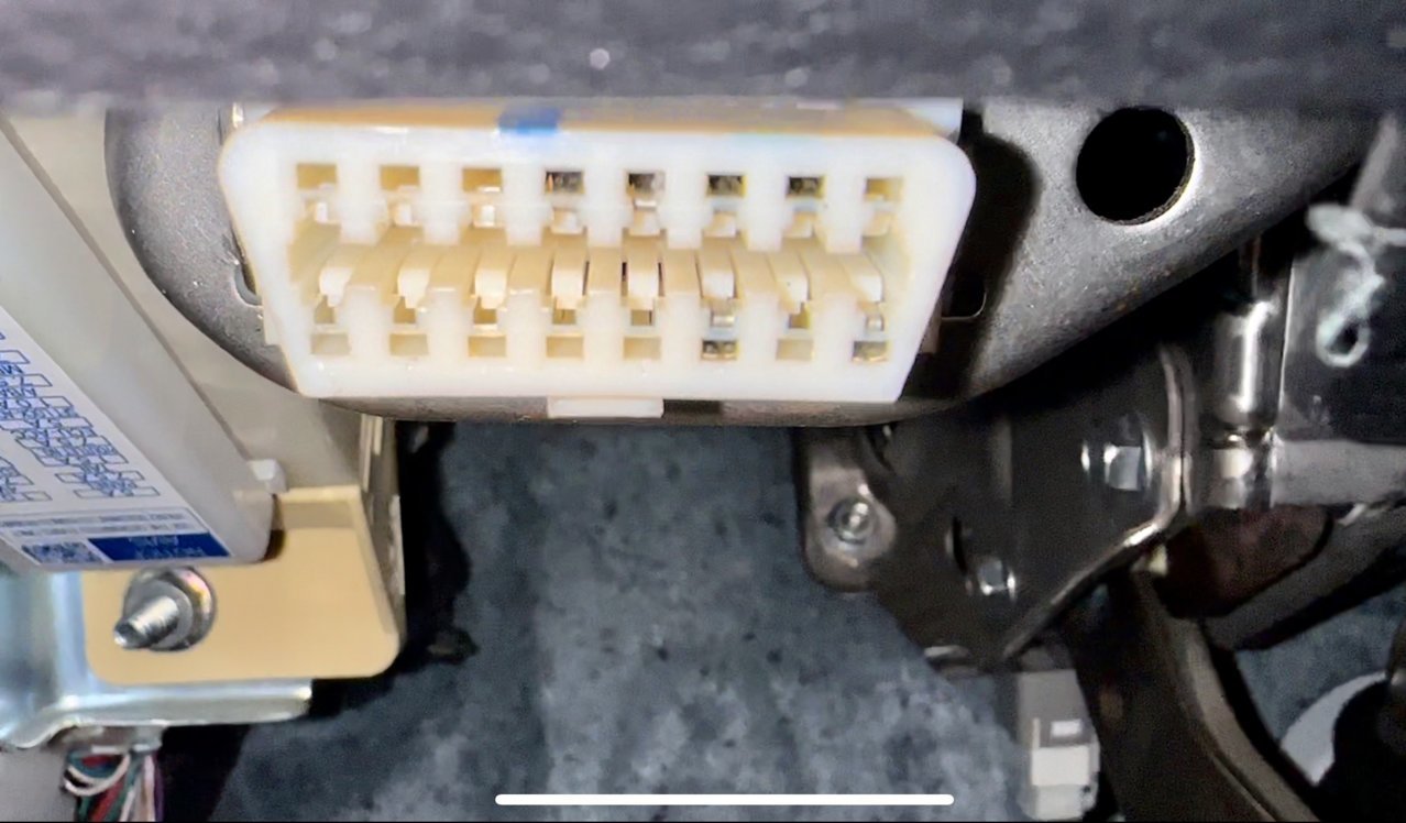

    Anybody got this working on a newer model? I don’t even have a #12 pin

    Whats your obd port look like

    E87504A8-E59E-400B-B23E-4039E09E0AF2.jpg This is what my OBD looks like

    Have you tried a "zero point calibration"?
    If you don't mind buying a scanner with ABS functions, or finding a friend that has one. It can possibly fix your issue.
    The Innova 5210 scanner can do it. Some people in this thread below were successful.
    https://www.tacomaworld.com/threads/steering-position-sensor-zero-out.716990/
