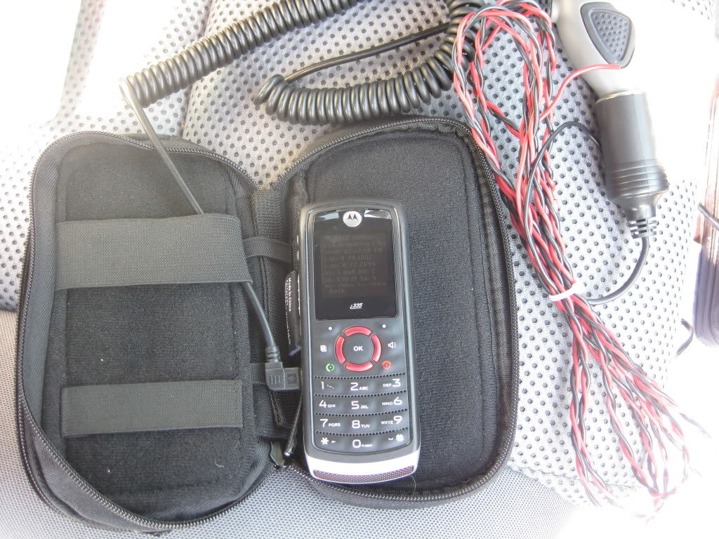

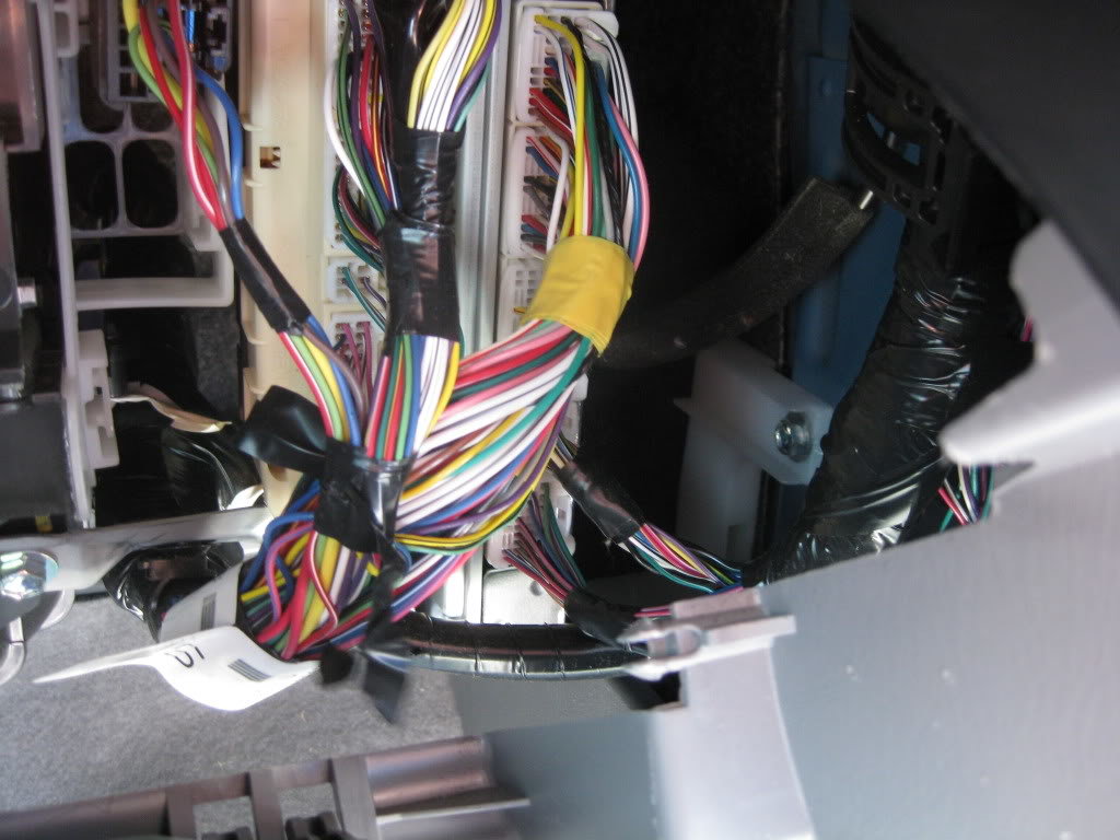

    Finally got some time to take a few pictures of this installation. Hopefully this will all make sense.
    I am not responsible for any damage you do to your vehicle.
    This is a picture of the Boost Mobile i415 that I was first using. You can pick these up on ebay for < $10.
    I ran across a good deal on an Boost Mobile i335, so I've been using that. The i335 doesn't support battery and signal strength, which you might want. If you use the i415, you can tell the state of the battery and signal strength on the www.gatrsystems.com website. Here's a picture of the i335. I purchased a $3 case (Big Lots) to store the phone and cables, while its installed under the dash.
    I made a six foot cable with 2 wires (red and black from Walmart) for power. I took a drill, locked the wires, pulled it tight and ran the drill for few seconds to get the tight twist. I took a female cigarette light power adapter from (Walmart) and connected this to the six foot cable. I just used a regular car charger for the phone and plugged that into the female receptable. Here's another picture.

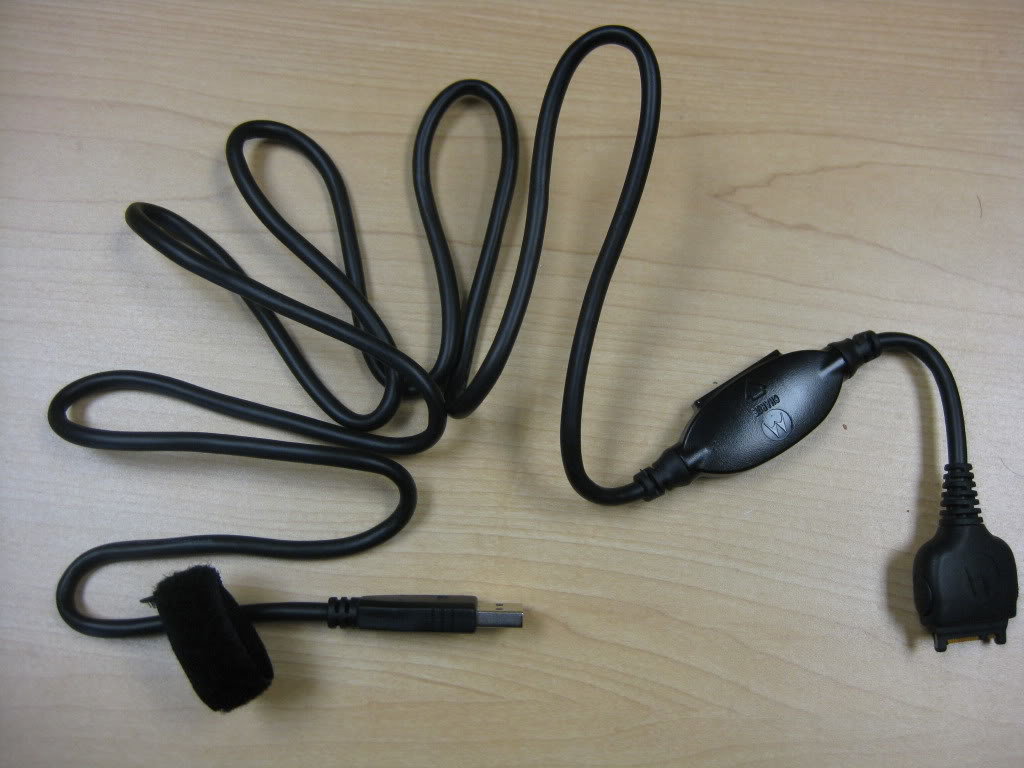

    I also purchased a data cable to download the GATR software to the phone. Here's a picture of one I picked up on ebay.

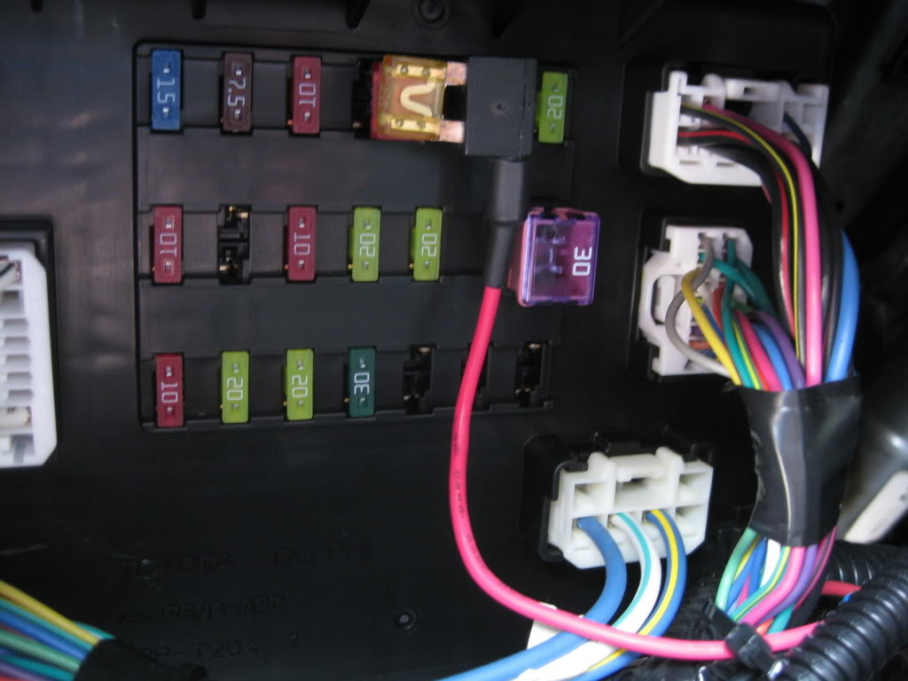

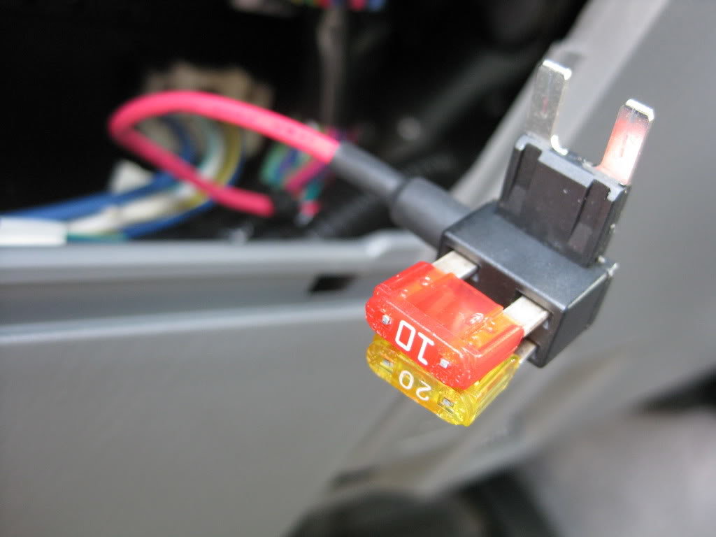

    I used an add-a-fuse device to connect to my six foot cable. Here's a picture of that.
    Here's a picture of it installed.

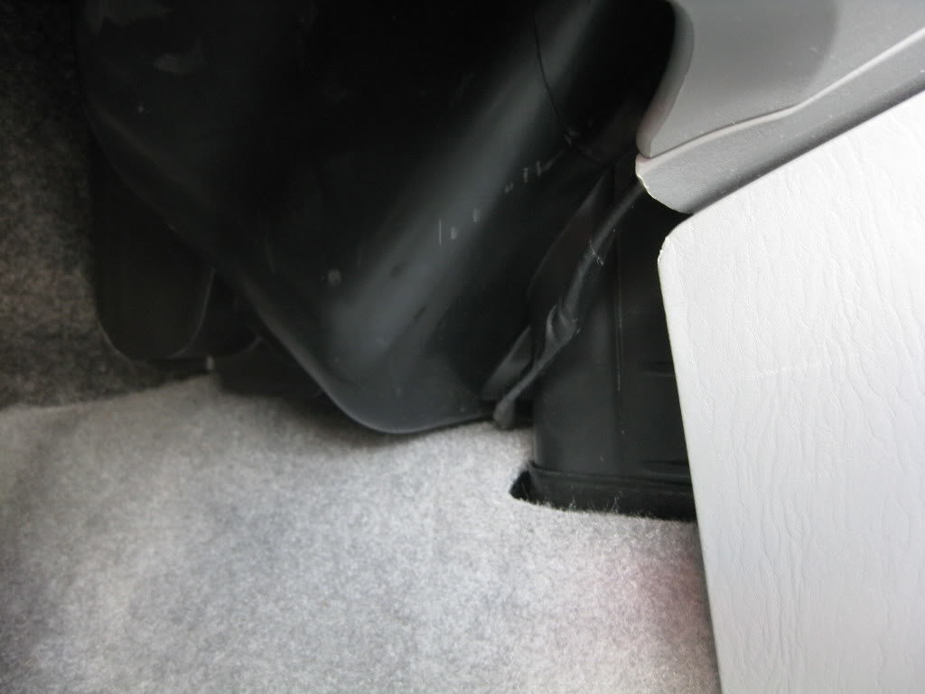

    I tie wrapped the six foot cable in the floorboard on the drivers side over to the center console. Here's a picture of the cable running behind the center console.

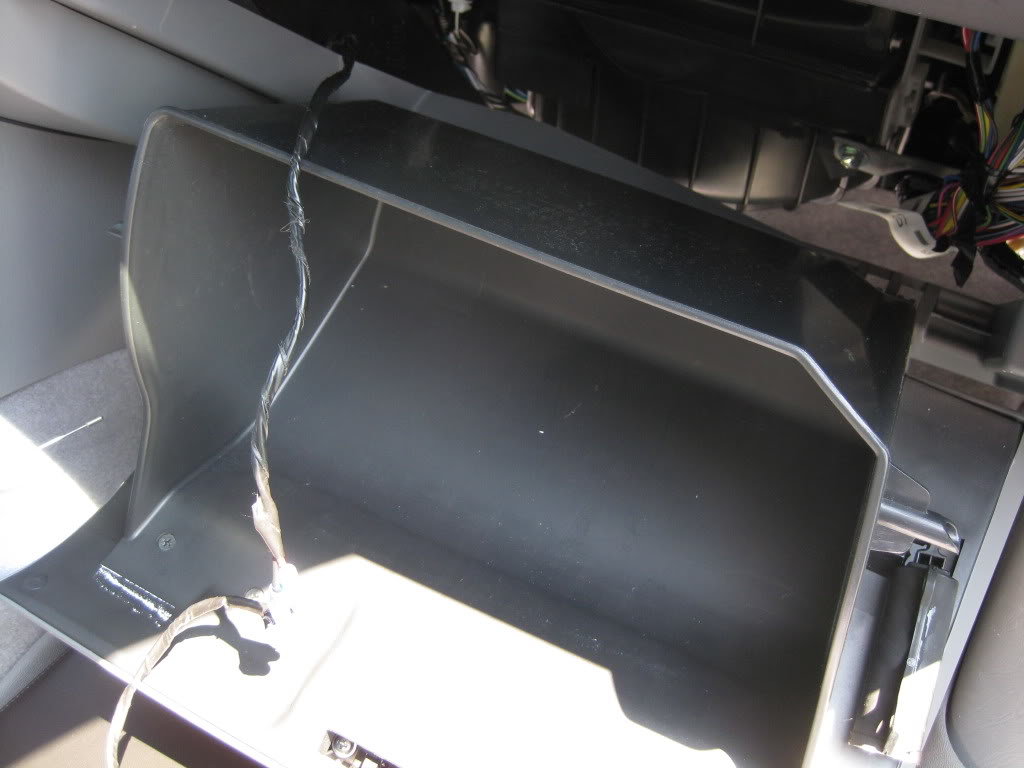

    I lowered the glovebox and disconnected the arm on the side so that I could drop the glovebox down. Here's a picture of the arm on the right hand side. The upper part of the arm just pops off to the left from a little plastic connector. Here's a picture of the arm.
    I brought the six foot cable from the center console and tie wrapped it up through the glovebox. Here's a picture of the glovebox dropped and the cable.
    I found two places to place the phone. There is an opening above the glovebox that will easily hold the case with phone and cable or there's a spot to the right of the glovebox. I was able to get GPS at both spots, although I would think the area above the glovebox would be best. You want to make sure you keep only glass and plastic between the phone and sky for the best GPS fix. Here's a picture of the area to the right of the glove box.
    Anyways, I hope that gives you a better idea of what I did.
    Again, I am not responsible for any damage you do to your vehicle installing this.
    Enjoy! If you have any questions let me know.
