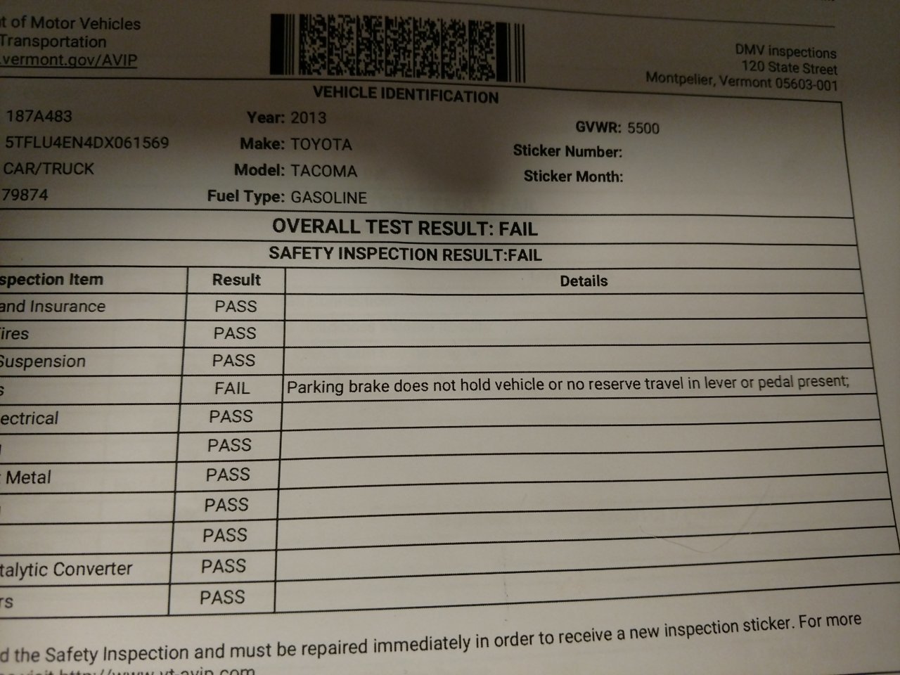

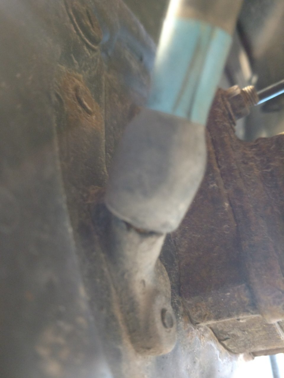

    Ok Dealership Rant!!! I bought my truck at Heritage. It's a 2013 with 80k. Heritage gives free state inspections for life. Today I got my winter's swapped over and asked if they would do a state inspection since I'm moving 2 hours away. Truck has a 6 sticker. Yup no problem we'll do that. Get a call saying my truck won't pass because the ebrake housing is cracked. I asked if the ebrake works. It did in the a.m. yes ebrake works. Pedal is hard. So I'm like wtf. Show me. The housing has a crack under the boot going the blackplate. You have to yank in this to see it. I'm like wtf why are you yanking on it then. Who does that at any other shop???? I was so pissed!!
    I ask well the ebrake works what is the problem? He said water & dirt may get in possibly stop the cable from working.
    Well now I know the reason why their inspections are FREE.
    My truck is pristine except for this potentially hairline cable housing. So my truck fails. Now in new State system. I'm like put my wheels on.
    I get my paperwork and it reads failed due to parking brake not working! Lie! What a crock of $hit.
    I feel better now.

    So now that it’s logged in the computer system, every shop is going to check for that “failure”?

    Yes.
    but my parking brake works.
    The tech said it works.
    If I were to go out to my truck and use the e brake the pedal is solid & holds forward and reverse. My trucks an auto.

    Yes with the new system the vehicle is now flagged. It will show up no matter what inspection shop you go to.

    The part is ill designed and the Toyota dealer knows it. I currently live 5 minutes walking distance to hertitage so to get my summer tires mounted and balanced was convienent. Shame on me for using the free inspection. The emergency brake works. That's all the DMV inspection manual states it has to do. I have a 6 so I'll wait to I move to Island Pond and get it done at a shop I know there. Live and learn. The write up for the fail says the pedsl doesn't work which is a flat lie.

    Funny I was just thinking yesterday about those free inspections promos dealers do. They do it at Berlin City Toyota in Portland as well. They’re fronting the cost of the inspection($12.50 in ME) so they have to recoup that cost somehow. I figured they just have to find ANYTHING wrong with almost every car to make that worth while. Now to recoup that cost for VT(over $40 something I think) they really have to step up their game. This is a prime example.. Not the best way to treat customers..
    What if you speak to the service manager and explain that this type of stress crack shouldn’t happen on a 5 year old vehicle.. maybe he would try and get the repair covered by Toyota as a good will repair? Might be worth a shot..

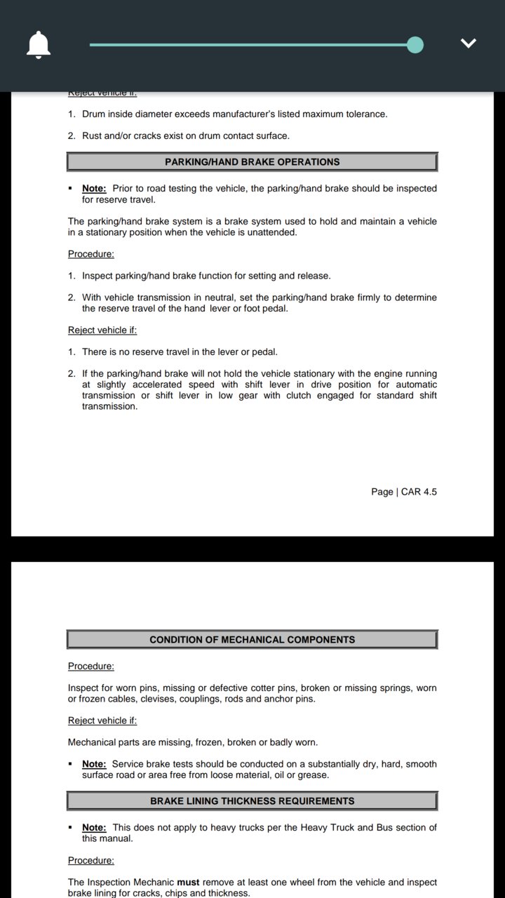

    Last I knew if the brake held it passed. That reserve thing how do they check it? Seems if it’s holding it could be made tighter seems like some bs. I got my daughters car at my local guy here her 12 Jetta has broken coil springs. I’ll ask him about what and how they check this. Free isn’t always lol pricks. Handys would mention cabin air/ air filter etc every friggin time. Told them they need to not touch anything other than why it’s there.

    My guy said by letter of the law the cables etc are supposed to be checked. He would say just to be safe the cables need to be replaced and being auto he would prolly just tell you.
    I think the reserve thing was for air brakes initially but it seems they have a clause about remaining adjustments now.
    I’ve watched the inspection laws pretty close and it seems they are gonna lighten up but shops still have to check that box.

    Yes my e brake holds on a hill after I put it neutral, or if I try to go forward & reverse with the gas. I get the cables replaced but not there. It's piss poor design if both sides of automatic 2013 Toyota with 80k needs ebraie cables. My 1995 vw cabrio 5 speed ebrake is fine. My 95 truck with 250k not a problem. Thanks for looking into for me Jeff! :)
