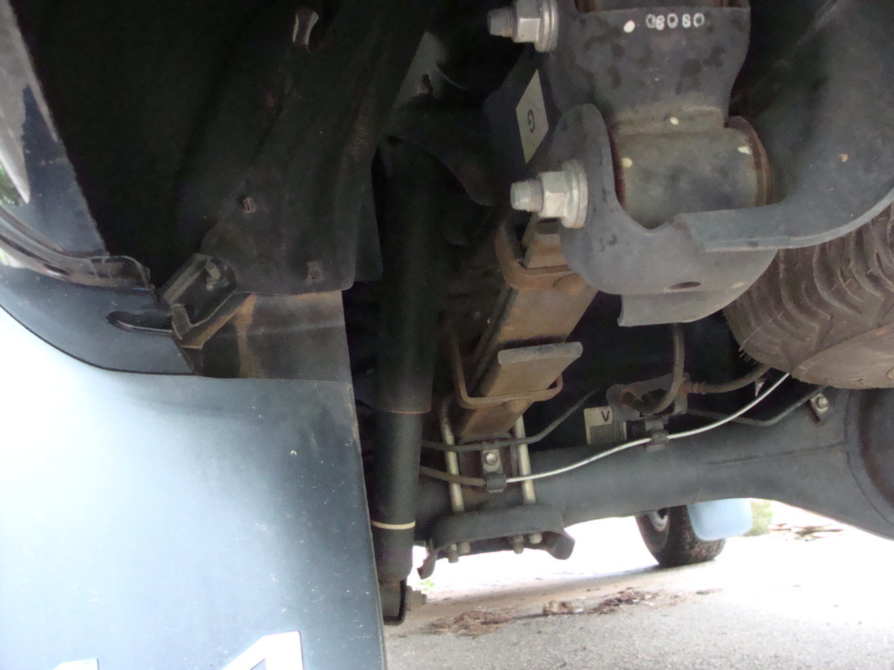

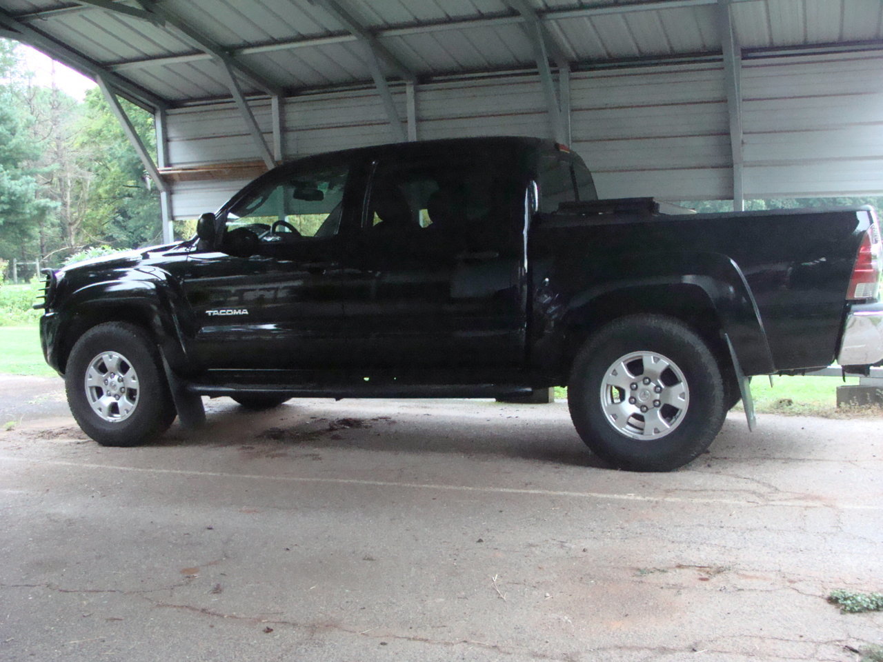

    If I raise the truck no more than 1 to 1-1/2 inches, the fronts won't rub when turning. I do not want to lift it any more than necessary. This is a stock 2011 SR5 DCSB 4x4. It sits about one inch higher in back than it does in front, and I like the stance; the rear springs have two full length leaves and one shorter, heavier leaf (see picture). Front is normal stock coilover, rear shock is stock.

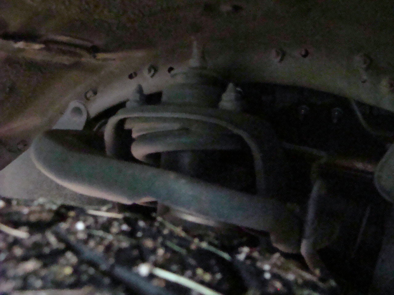

    I figure the leaf spacer block is fairly straightforward, unbolt springs from axle, insert spacer and replace springs, but how involved is putting the spacer in the coilover up front? Does it go above the spring retainer? (Meaning, unbolt the coilover from up top, without removing spring from shock, insert spacer between coilover and its top mount, then replace coilover?

    Did you have the leaf spring recall completed? It looks like the old pre-TSB spring still.

    What's the deal with the TSB and the rear springs? What year models did that affect? I bought my truck used 2-1/2 years ago, had 42K (I have 95K now). The rear of my truck is slightly higher than the front, which I like, and I tow quite often and never have any issue with the truck squatting with a hefty tongue weight (200-250 lbs or so). I've read some about the recall, but what I read said the bad springs lose their tension and the ass of the truck begins to sag, and trailer loads really drop the back end.

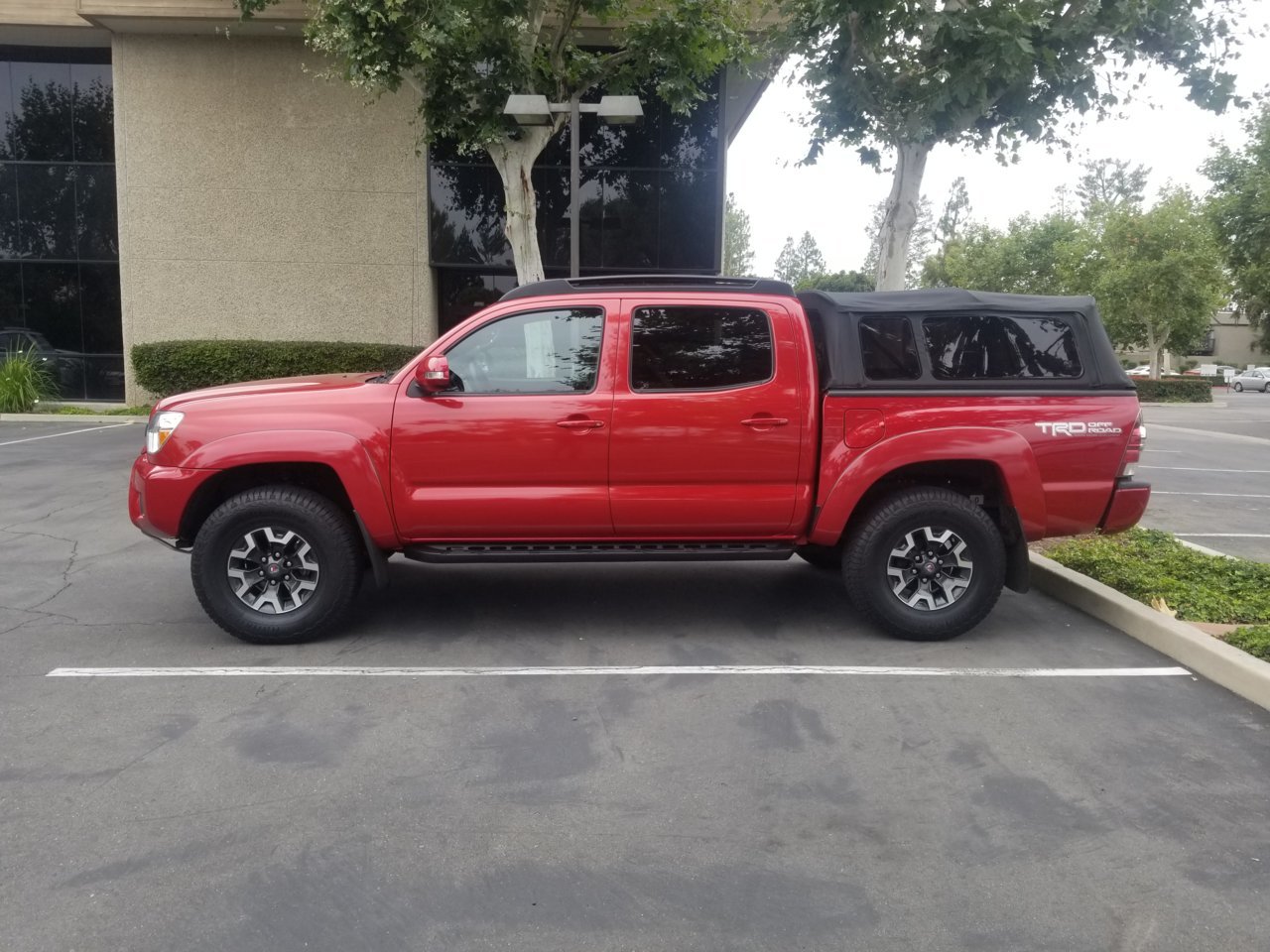

    3rd gen suspension is your best option. It's cheap and gets you the 1inch lift your looking for. I too had the old 2+1 leaf pack and when I swapped it out for a 3rd gen it gave me 0.5in lift. Overall I added a 1/4 headstrong spacers in the front to give me a total of 1.5in lift and rear I added a 1/2 toytec flat shims to give me a total of 1in. Rides and looks great. Unfortunately I've been bitten by the tacomaworld bug and want to go higher now but I'm happy to leave the truck the way it sits til I get a good deal on some coilovers. I was lucky enough to get everything cheap and used except for the toytec flat shim but those don't cost too much. I did all the work and spent no more than $250 for everything.
