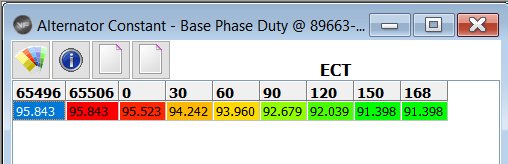

    Here are my exact 0A461 values for anyone that is interested.
    FYI for those of you taking pictures of your computer screen with your phone (looking at you @RangerComa :D), use the shortcut: Win (Windows key) + Shift + S to open the screenshot/snipping tool and select the section of the screen you want to capture. It will automatically copy it to your clipboard and you can just paste it directly in your post.

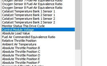

    I haven't, just been monitoring real time. TBH, don't know how to log or what to use. I looked at the VF tuner logging but it looked like it didn't track voltage. Happy to do it though if you can give some guidance.

  17. Dec 10, 2020 at 2:10 PM
    #217
    ihatemytruck
    ihatemytruck Smartass
    Jul 26, 2013
    #109078
    1,636
    Dave
    Southern California
    '17 Tacoma 4x4 off road DCLB
    There's a pid for it a little more than halfway down the list in the vf logger....control module voltage or something similar.

    Good memory. Found it!

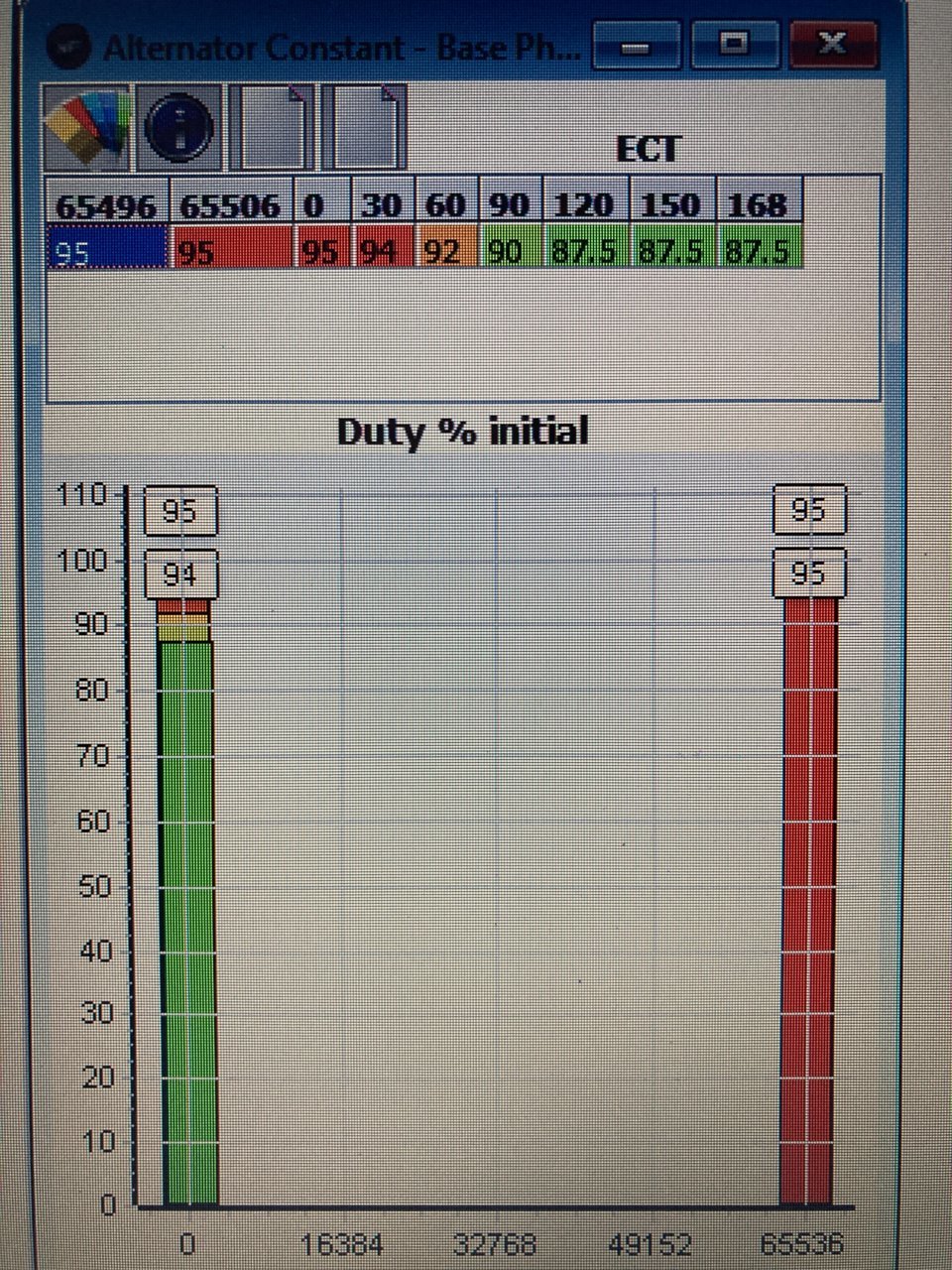

  20. Dec 11, 2020 at 4:34 PM
    #220
    RangerComa
    RangerComa 58008
    Mar 14, 2017
    #213317
    2,829
    Adam
    Marin, CA
    17 DCLB
    list is growing fast
    this screenshot is for you @tacomarin
    %5 w/o going over 96 at the lowest temps
