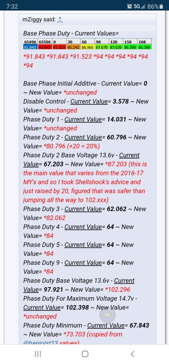

    This method netted constant 14.4+, using the proven method from @Shellshock
    However, it does not taper. I haven't had anybody available for testing, so I eventually gave up on it and figured eventually someone else would figure it out.

    I’ve done it on a 19. Should net the same result on an 18. All the tables are the same.

    I thought this did taper since i see people posting new numbers for 18s but nothing about the Phase Duty numbers like @tacomarin Do yours Taper with the heat? And what did u do with thw Phase Duty numbers?
    For our 18s
  11. Dec 12, 2020 at 2:03 PM

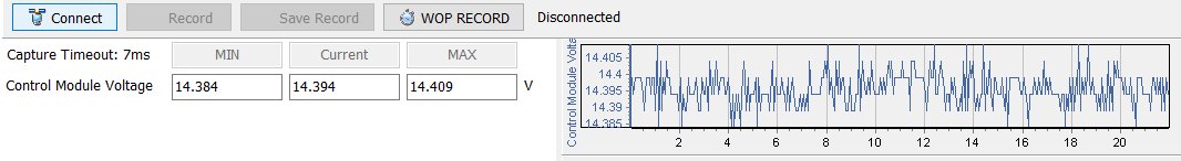

    I am running these number on 18 and monitoring with Scan gauge. Voltage is constant at 14.2V - 14.3V It does drop in the 13.8V range occasionally at idle. Outside temperatures have been in the 40s - 70s F the last couple weeks but I have seen no changes in Charging Voltage. I haven't tried VFT logger but I'm going to see it I can make it happen right now.:fingerscrossed:

    First time at Logging. I am sitting in my driveway in North Texas at a mild 58 degrees F

    From what @Shellshock said these numbers won't Taper. So i guess they wont lower when the temperature will go up. I had a buddy do my tune. So im tryinf 2 get something that will taper on those dessert runs. But will stay constant with those mountain cold weather also.
    I'll be keeping a eye out @tacomarin numbers and logs now.

    I wouldnt adjust the voltage output without also adjusting the phase duties.. You’ll either get inconsistent output, not get the desired output, or a variety of other things. You need to do both.

    I am not any of those guys but I think it's not worth it. Your numbers across the top that go horizontally tell it how to behave by engine temp. The phase duties tell it how to behave regardless of engine temp. You should be altering all relevant values, not just some of them

    I saw ur post on the vf tuner site for our 18s. But i did notice ur ect values don't taper with temp. What about doing tacomarins numbers with ur Phase Duty numbers? So they taper?
