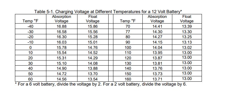

    Hey everyone,
    After some research I am finding that i think we may be charging our AGM batteries a bit high with the alternator settings, but I cannot confirm because this is not my expertise. I am no battery/voltage expert so this stuff is new to me, just trying to make sense of the standard for AGM.
    What I am finding is below, please share your thoughts if you like:
    https://shop.pkys.com/AGM-Battery-Recommended-Charge-Parameters.html
    Another source here cites:
    WHAT IS THE IDEAL CAR BATTERY VOLTAGE YOU CAN HAVE?
    Measuring your car battery’s voltage can be a great way to determine how charged your battery might be. The ideal car battery voltage range will provide you with a relevant interval according to which you can measure precisely what the voltage says about the battery’s current charge. A perfect voltage with the engine running is between 13.7 and 14.7V. With the engine off, you should get a reading of 12.6 volts. If the battery isn’t fully charged, it will diminish to 12.4V at 75%, 12V when it’s only operating at 25%, and down to 11.9V when it’s completely discharged. This data and the way it relates to the design of your battery should provide you with some useful insight into the functioning capacity of your car battery."
    https://shop.advanceautoparts.com/r/advice/car-maintenance/car-battery-voltage-range

    What’s weird is I smelt a slight weird smell coming from my engine bay yesterday after a little drive. Opened it up and my sniffer confirmed it coming from the battery. Checked the voltage with the engine off and the battery is at 12.56 volts with a multimeter.
    Something doesn’t seem quite right and that was the first time I have ever smelt that smell parking in my garage in the same spot. Who the F*** do we have to get in here to set a standard for AGM values in these damn tables? It’s 2021 let’s do this. @Shellshock, adjusts just the main ECU table right? Any issues? Seems legit, but can’t be sure (no offense). Your “keeping the factory curve” makes sense.
    Im gonna be super pissed if I have to drive 8 miles all the way back to Costco and exchange this batt for a new one. Gonna be more pissed if this bitch explodes
    :bananadead:
    @OVTune ?

    If I remember right the voltage of a fully charged AGM battery is 13.0-12.7v so the 12.5v you tested at the battery is within limits.

    according to the links I posted 12.6 is fully charged, but yes

    I switched over to stock tables last night, but just raised the ECU table to 94 from 0 up
    Now it sits charging while driving at 14.3-14.4 which makes me feel better.
