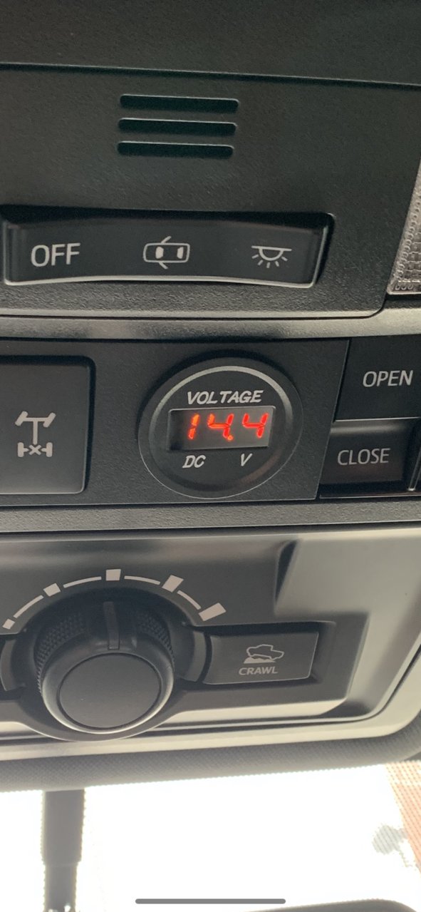

    I just had mine reflashed this morning with @SpeySquatch map that he screen captured and posted. It’s 0° here in Denver and it’s been 14.4 steady while driving. I would notice some dips in voltage when I shift to reverse and back but I’ll keep an eye on it from here. 2016 here.

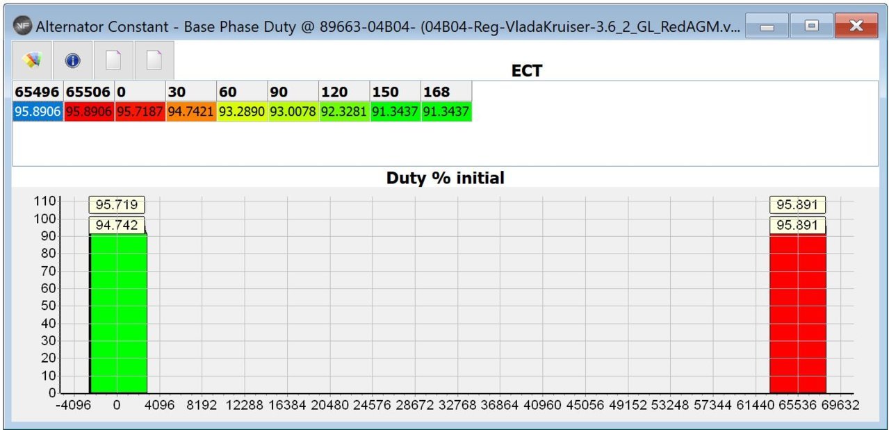

    I'm running a X2 24F with these settings with good results.

    I no longer change any of the other values. I leave those stock. Seems to be working ok for me so far.

    With these settings, I'm getting around 14.6 until the ECT gets higher, then down to 14.5. lower at idle and after coming to a stop.

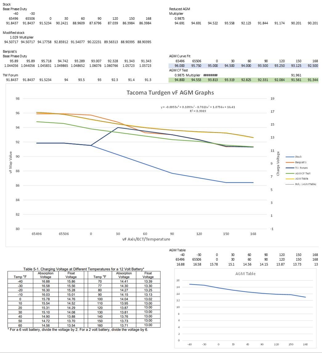

    I've been looking more into the AGM preferred settings and watching what others are doing. I've ran many of the settings shown in this thread. Some were a little hot for my tastes, others were too low. Some don't fluctuate at all with temperature, so those scared me.
    The table for AGM charge voltages posted earlier in this thread shows what AGM's like vs temperature in theory. I plotted that to see the curve shape. Then I overlaid that on plots of the values we are changing in the vF software that supposedly correlate to temperatures also. What I'm seeing is the AGM table is a flatter curve than what the ECU comes stock for the flooded batteries, and vs what other users are putting in. I got the equation of the AGM curve, and then plotted a similar curve to get the values to put into vF. Then I applied a knockdown factor (.9875 in the example below) to that just to have some margin.
    Some of you are ignoring the low temp values and only adjusting from 30 on. I'm assuming this is because your trucks may never see -40F, etc... For the most part, all the values we are all using are very similar from 30 - 160. It's the cold side where we are doing different things.
    Anyway, the charts below are the tinkering I've done. I'm currently running the green line and green cell values and am getting between 14.5 and 14.3 at 30-50 degrees F here in UT. I've been playing with the multiplier targeting 14.5 to 14.3. On a few cold mornings I'll get 14.7 at start up so i think it's doing what it should be.
