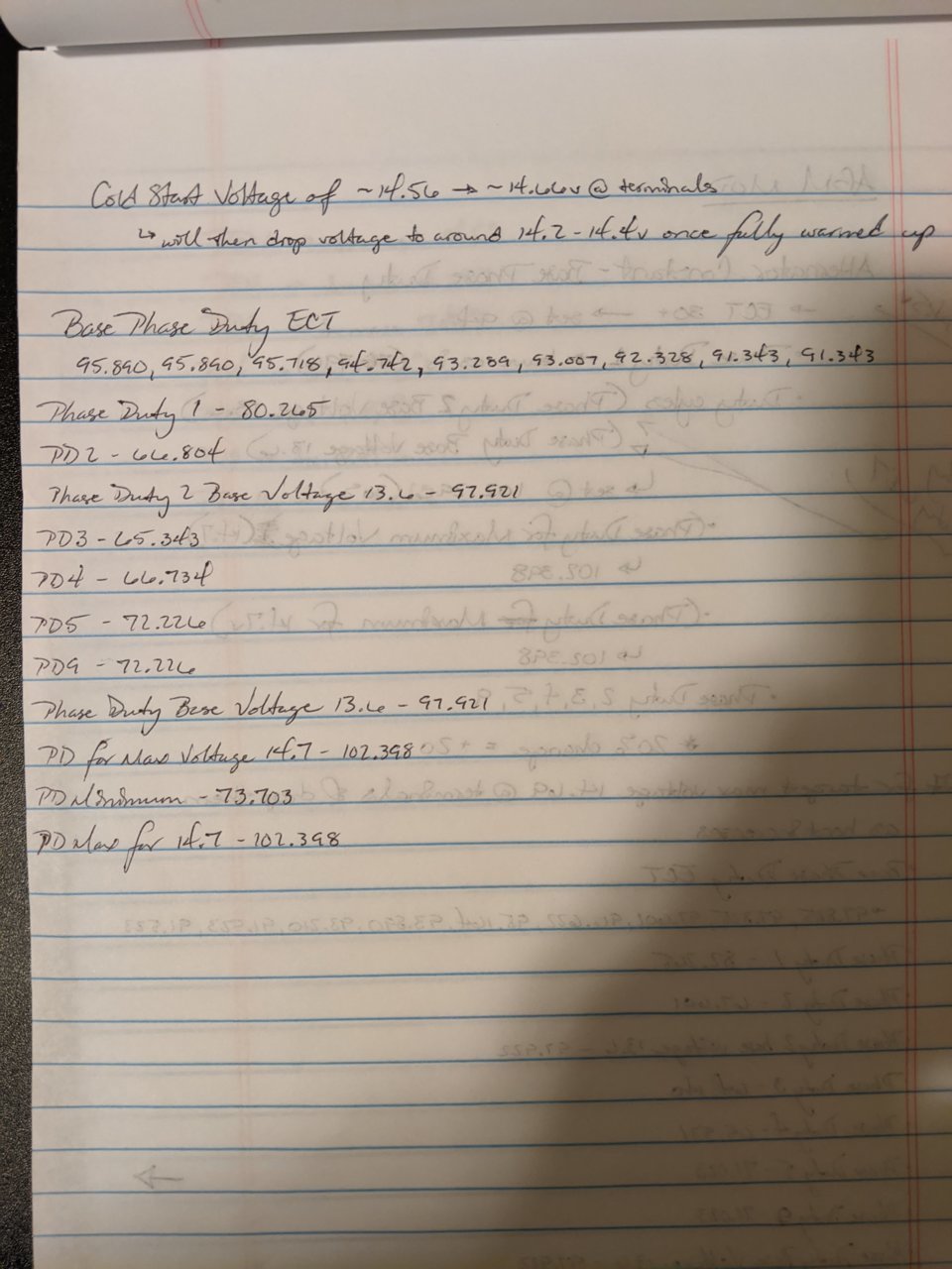

    These are the settings I'm using on my 2017 MT. The results are posted somewhere ahead in this thread, late last week. My battery as stated previously is an Odyssey 34R-790

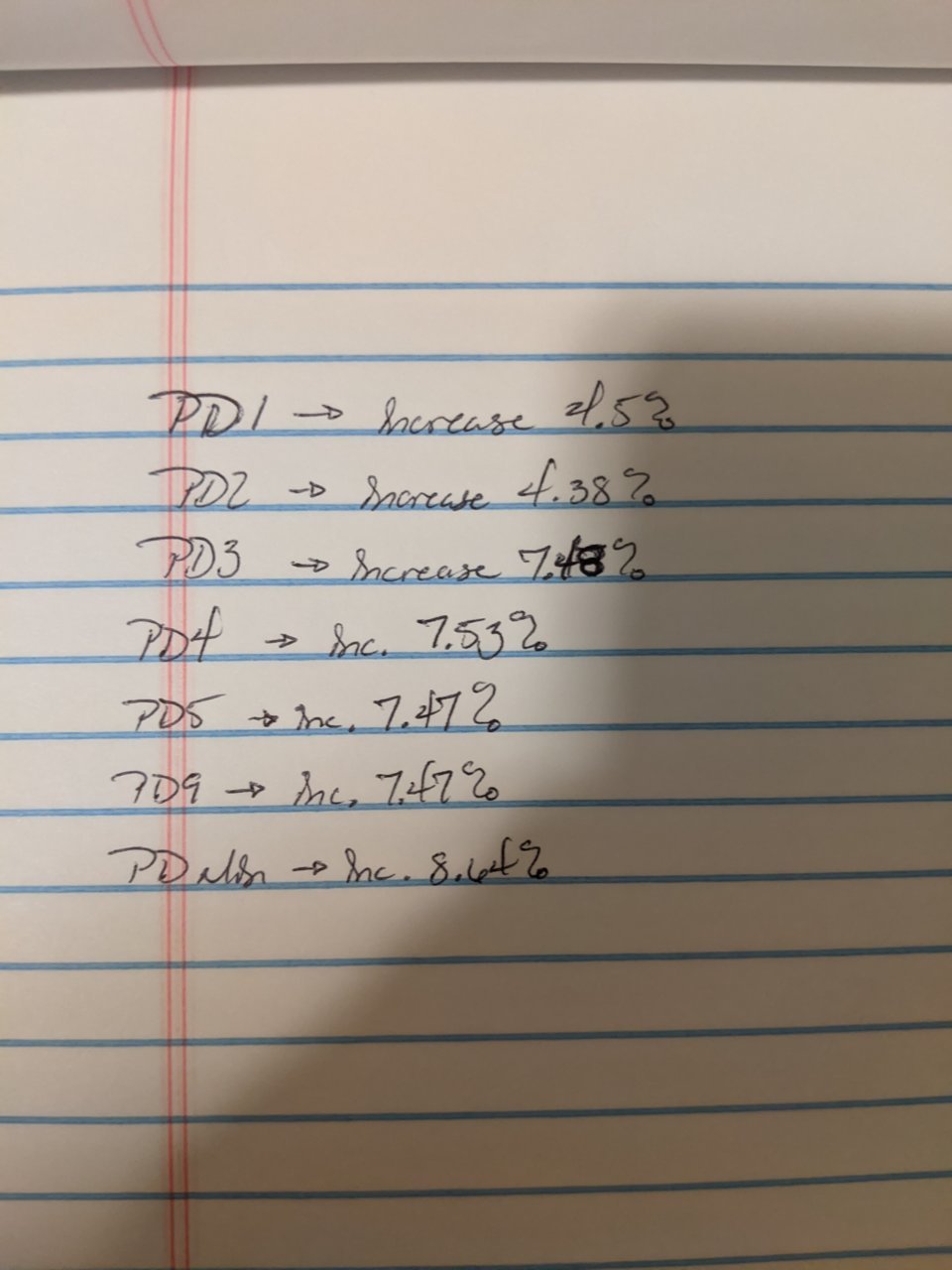

    When working on doing something similar for a 2018 AT, I worked out the percentages that @banjoist13 had increased the PD values by for our 2016-17 trucks. Here they are (I didn't math out the differences for the first table dealing with engine temp):
    The two maps I've sent over to my buddy are the results of that math. I sent out one where I increased the 04A61 OEM values by these percentages, and then another where I raised the Base Duty 13.6 tables to the same values used in @Shellshock 's AGM edit.
    At least we know through proven testing that Shellshock's edit works properly as a fallback. When in doubt, his values will have your AGM battery at an appropriate voltage, and it won't drop.
    What I'm working on is just building off of Banjo's successful work on our 2016-17 MY's, and trying to adapt that taper to a 2018
    Shellshock likes this.

    Your handwriting is way better than mine..

    turns out i already had all these exact settings down to the 1000ths. cool. thanks again.

    This is my "shitty" handwriting lol like a printing-cursive hybrid. I actually have very girly beautiful writing when not hand-jamming stuff lol
