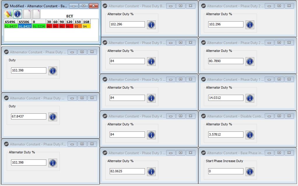

    Need some help. Getting check charging system error at idle in drive while having electrical loads active. Voltage drops below 13v.
    here’s a video showing the issue.
    https://youtu.be/T6Bz3OMhE0g
    basically while at idle with foot on the brake and electrical loads active, head lights, puddle, heater, seat warmers, etc. my voltage drops below 12v. If I put it in park and engine surges up to around 650rpm the voltage comes back to 14.5~14.6v. Any ideas what settings I should play with to help?
    As soon as I’m driving around I’m constant around 14.5~14.6v it’s just at idle In drive with loads on.
    here’s my current settings truck is a 2019 running 2.0F 91 5.29 33” tune with these settings tweaked for charging. 04b33
    65496 65506 0 30 60 90 120 150 168
    91.8437 91.8437 91.5234 94 94 94 94 94 94
    base phase initial additive, (start phase increast duty) 0
    alternator constant disable control (alternator duty %) 3.57812
    alternator constant phase duty 1 (alternator duty %) 14.0312
    alternator constant phase duty 2 (alternator duty %) 102.296
    alternator constant phase duty 3 (alternator duty %) 82.0625
    alternator constant phase duty 4 (alternator duty %) 84
    alternator constant phase duty 5 (alternator duty %) 84
    alternator constant phase duty 9 (alternator duty %) 84
    alternator constant phase duty base voltage (alternator duty %) 102.296
    alternator constant phase duty for maximum voltage 14.7 (alternator duty %) 102.398
    alternator constant phase duty miniumum (duty) 67.8437
    alternator constant phase duty maximum for voltage 14.7 (duty) 102.398

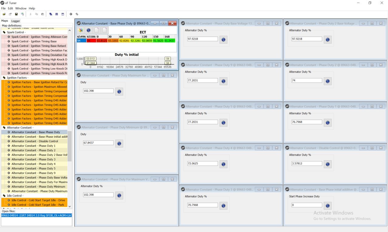

    Here’s my default values
    And the settings I copied bumped down to 94. Started at this. Went to all 95’s from 96 in fields 30-168. then to all 94’s in fields 30-168 from 96’s to dial it in.

    Is 650 the default idle or did you adjust that?
    what if you adjust it up a bit? Seems like there just isn’t enough rpm for the power output since it’s working fine when driving.

    u talking about my idle rpm? I haven’t touched anything tune related other than these agm settings and gear lock settings. I’ll double check my rpm after work to get an exact idle speed in drive.
    should be whatever 2.0f 91oct 33” 5.29 non thx is.

    You could try bumping up each phase duty one at a time to see if one controls the output for idle while in drive.

    That's kinda what i was thinking, that one of them maybe controls that specific area and needs to be turned up.

    It looks like you bumped them all up. All i did was skip phase duty 1, then +20 to the rest of the stock values (not to exceed the 102.3 number)

    looks like i did not touch my "altenator constant phase duty minimum" maybe i should bump this up from stock at 67.8437 to 87.8437? see if that does it? any thoughts on this map value.

    Give it a shot and monitor. Worst case, you flash back to a previous tune.

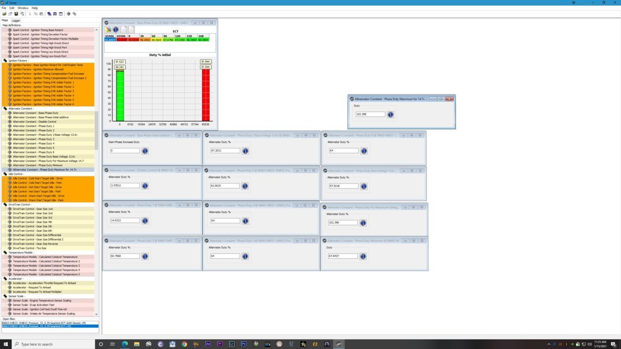

    This is my updated agm tune with a taper similar to stock
