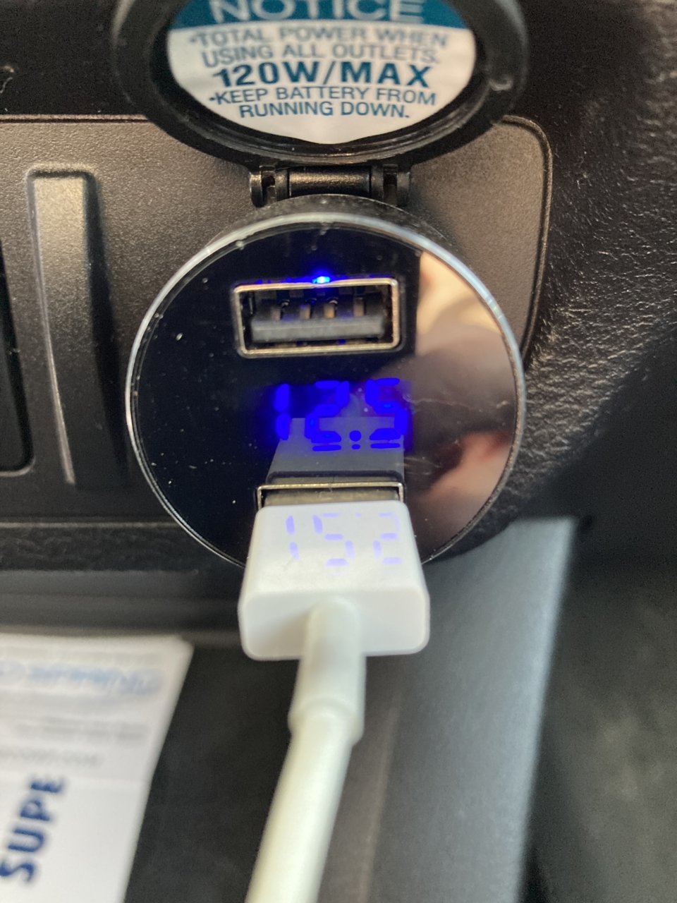

    after working a 10 hour shift yesterday I noticed my car turn over slow. seemed weird, got home and checked battery voltage at the terminal posts and was registering around 12.0v. Took it for an hour drive charging at 14.5v on scangauge and verified at battery posts. I then un hooked the battery from the car and let it charge on a 2.0 Amp charger for 8 hours over night. I know this isn't ideal, but it's the only charger I own. In the morning i'm at 12.3v. I hook it up to the truck. Drive to work for about a 15 minute drive charging at 14.5v. Shut it off wait about 3 min and check voltage at the posts and i'm at 11.9v.
    I did do a quick parasitic drain test with my volt meter in line, but didn't wait very long for the car to shut down last night and was showing .500 amp draw with everything off. This may settle down over some time and will re check this. Also checked with an amp clamp and engine running saw 20amps going to the battery at 14.5v. I'm starting to think i have a bad 3 month old northstar x2 or maybe a drain. will investigate, but seems odd that it's not really holding a charge. I'm going to pull it out of the truck and fully charge it and put in a backup battery.
    only things i've done recently was flashed a bunch playing with idle maps and some alternator settings to attempt to fix my voltage drop in D at idle with loads active. This was saturday night. the very last flash to the ecu i flashed back to my initial settings I turned the ignition to the off position after flashing and didn't turn on and start the car until the next morning. it fired right up sunday morning.
    been running the following adjustments since the battery was installed late january of this year 04b33 2019 truck. (aside from some quick adjustments which led back to these settings)

    Quick update. Dropped the Northstar x2 off at batteries plus last night. They charged it and tested it this morning. Tested bad. Called me this am and picked up a new battery. Fingers crossed on this one. Dead in less than 2 months... also did a parasitic drain test and passed. Drawing .048 amps. .09 with my telematic gps and dimmer switch installed.

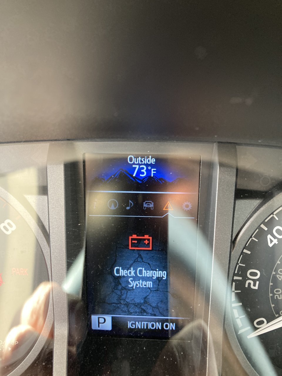

    Anybody else seeing this with truck off but accessory mode on (2 button pushes)? My voltage with truck off seems normal.
    with the truck on, it doesn’t show

    That’s normal. Happens stock
    truck is drawing power and no power is going in so puts up that screen

    Guess I never really noticed until we AGM guys started messing with things. Thanks
