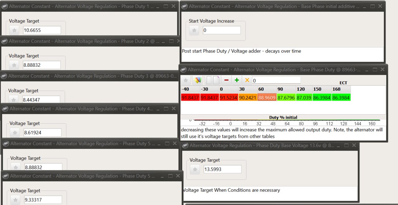

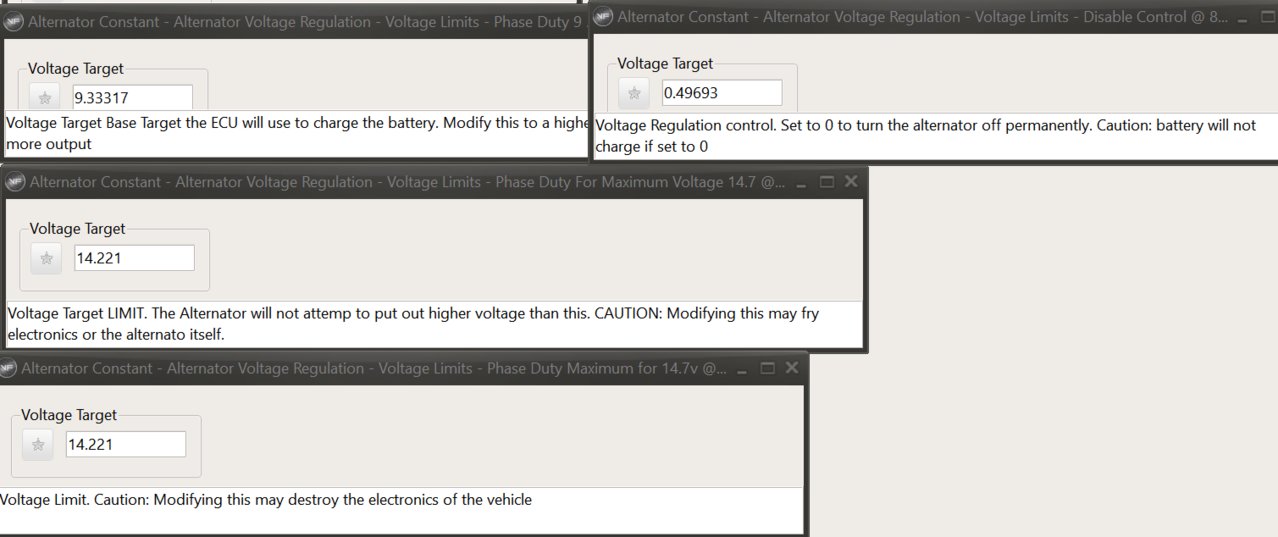

    Does anyone here have any experience with 04C21?
    Recently purchased a vf tuner and my main goal is to adjust for a future AGM.
    All or most of my fields and values are not matching others I see on this thread

    planning to flash my truck to the latest values posted by @BortisYeltzen this week, im curious, did you also up the duty cycles +20 past cycle 1 as @Shellshock suggested in a previous post, or did you leave those values alone?
    looking for comments from anyone on what to do with duty cycles but pretty confident in the data provided by @BortisYeltzen for the ECTs

    Leave the other values alone. Just change the one table. Keep it simple. I backed off slightly on the settings and what is shown below should give 14.3V consistently. No need for more than that.

    thank you!!! just made these changes to my OV tune 2.0 file and riding steady just below 14.3V. much appreciated.

    Can anyone give me some guidance on how to get to the correct area on my VF Tuner 1.7 Legacy version to change the values in order to have my alternator setup for an AGM battery? I've been looking around this thread for about a week, and I see some figures to enter, but I don't see where to go in order to change the values. I see the list under the OBD logger, but am just not sure what to choose and what not.
    About 2 years ago, I did the OV Premium fuel tune on my truck. That was preset and had all the instructions. Changing the alternator figures seems a little bit more involved without any good videos or step by step instructions. Thanks in advance!

    You have 2 alternator tabs in the 3rd Gen Tacoma file. The 1st tab has that table in it.
