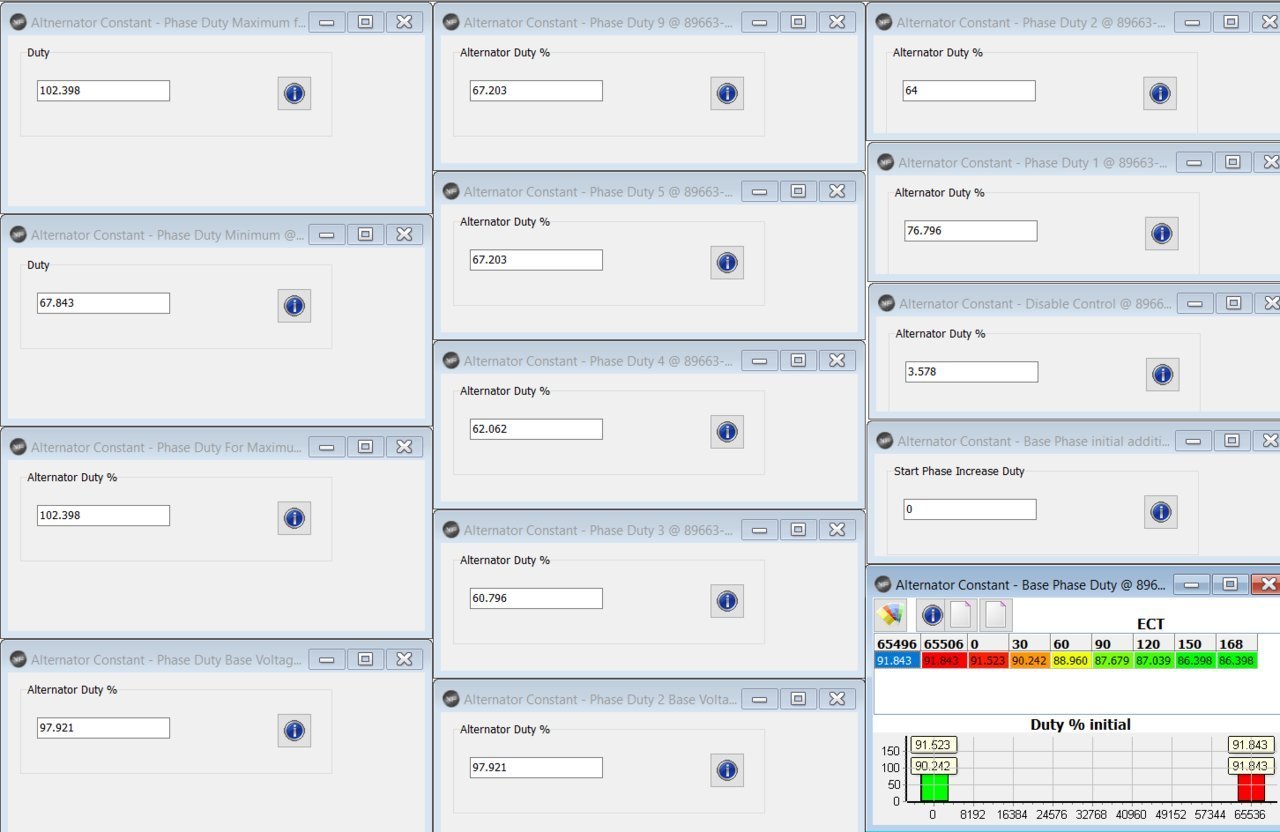

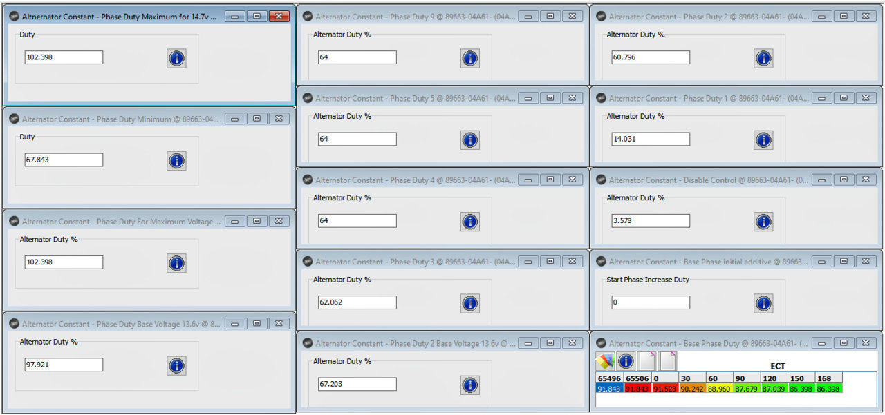

    04B14 (Stock)

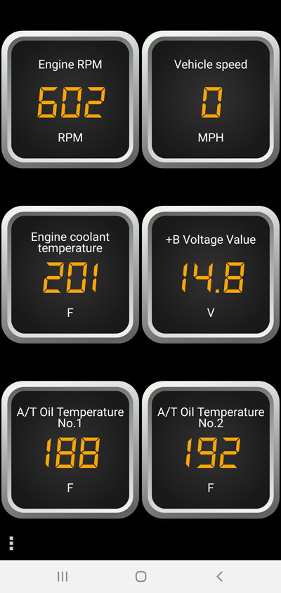

  6. Oct 21, 2020 at 3:07 PM
    #46
    WHTLTNG
    WHTLTNG White Lightning
    Apr 13, 2020
    #324611
    40

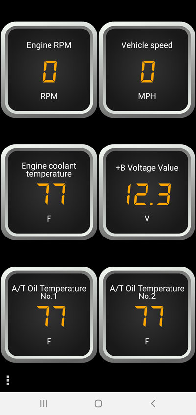

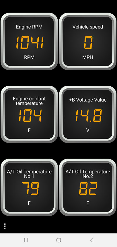

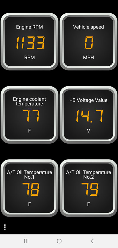

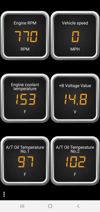

    Below are pics of my volts at different temps (ECT). Also while driving they would stabilize to 14.7v to 14.8v. I have not verified at the battery yet. I have not made any adjustments.
    If I need to adjust the volts up or down a bit, what would I change?
    Then what would I change to bring the volts down when the Engine Coolant Temperature (ECT) rises.
    @mZiggy @banjoist13 @Shellshock
  7. Oct 21, 2020 at 3:13 PM
    #47
    Shellshock
    Nov 21, 2015
    #170338
    23,266
    Iowa
    Change the base phase duty values up or down. Exactly which phase they correspond to, we don’t exactly know. I’d either set them all the same or bump them up all by the same amount to keep the factory curve

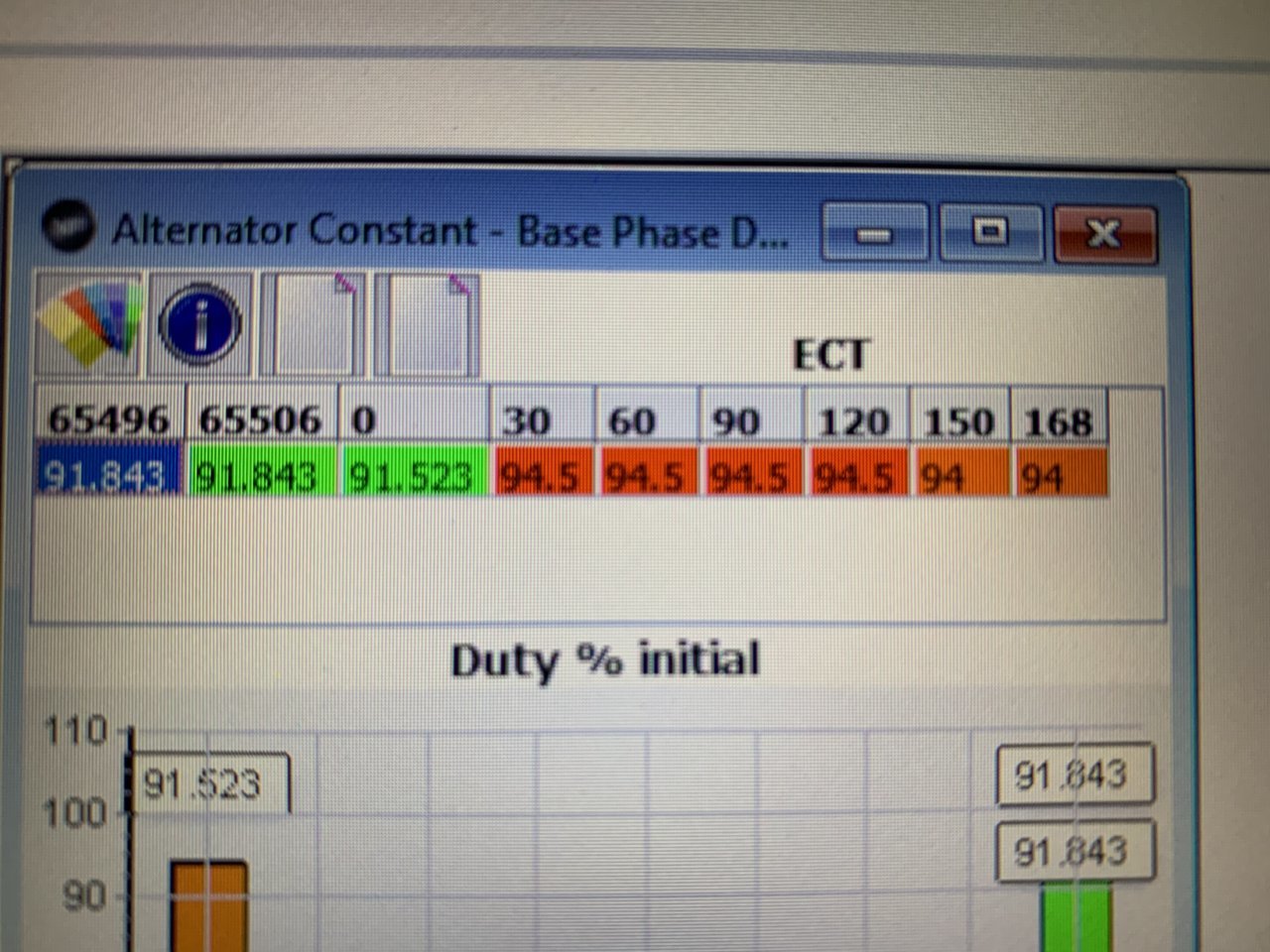

  8. Oct 21, 2020 at 8:29 PM
    #48
    WHTLTNG
    Apr 13, 2020
    #324611
    40
    The base phase duty axis numbers are confusing.
    If they are °F they kind of make more sense.
    If they are °C they are even more confusing.
    The 65496 & 65506 = WTF.
    If the values are °C.
    Then °F would be.
    65496=WTF?
    65506=WTF?
    0=32F
    30=86F
    60=140F
    90=194F
    120=248F
    150=302F
    168=334F
    @OVTune
  9. Oct 21, 2020 at 8:31 PM
    #49
    Shellshock
    Nov 21, 2015
    #170338
    23,266
    Iowa
    Thats why i made all mine the same number lol ill adjust once we actually know what it means. In the mean time my voltage stays consistent.

  11. Oct 21, 2020 at 9:27 PM
    #51
    sd1uh8as
    sd1uh8as Well-Known Member
    May 25, 2018
    #254462
    1,435
    Ivan
    Bay Area
    2018 Tacoma OR DCLB
    The 65496 is most likely a computer-related value.
    It probably represents a value with max size of 2 bytes.
    1 byte = 8 bits thus 2^16 = 65536.
    Edit: looking at the screenies, its probably some sort of placeholder.
    Edit2: or can be used as some sort of bias value to compare against. they probably put some logic in there to do that. its like storing a variable for later use.

  14. Oct 23, 2020 at 9:39 AM
    #54
    sd1uh8as
    May 25, 2018
    #254462
    1,435
    Ivan
    Bay Area
    2018 Tacoma OR DCLB
    Yep, there you go. Thanks for the assist. Makes a lot of sense.

  18. Oct 23, 2020 at 12:09 PM
    #58
    Supr4Lo
    Supr4Lo Well-Known Member
    Jul 23, 2018
    #260306
    3,563
    Jason
    Surprise, AZ
    2020 DCSB Offroad MT, Supercharged, NWF Eco-Crawler, 4.88's Locked F&R on 37's
    Found some info for Northstar automotive AGM battries
  19. Oct 23, 2020 at 12:56 PM
    #59
    Naonak
    Naonak Mike Oxyuge
    May 14, 2019
    #293291
    154
    2017 Tacoma TRD Off-Road
    I got a quick answer from Northstar. Pretty much tells us what we need to know for Northstar batteries at least:
    Assuming ideal charge voltage of 14.5v @ 25C that puts the table at:
    Code:
    Temp (C) Voltage
    -40 15.67v
    -30 15.49v
    0 14.95v
    30 14.41v
    60 13.87v
    90 13.33v
    120 12.79v
    150 12.25v
    168 11.926v
