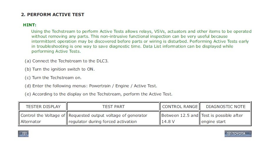

    Can you request the desired voltage(s) and freeze frame the duty cycles?

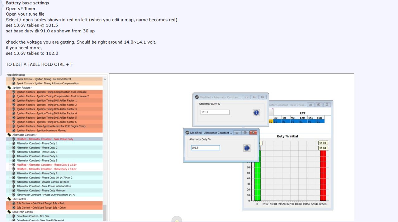

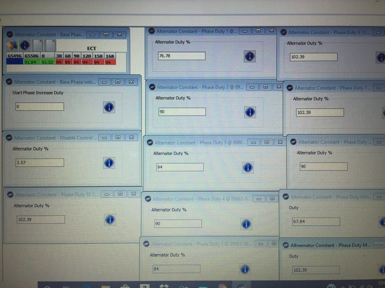

    Here is a screenshot of Mats AGM instructions. I have my base phase duty set from 30 and up set at 94. Phase duty 6 and 7 i believe have been re named but i have them set at 102.398 gives me 14.5 volts when warm and i believe 14.3 when cold. Have had no issue's. 14.5 volts is a good setting that i like! You can up those to whatever you like!

    Just found this. Posting what I’ve used for an interstate AGM here:

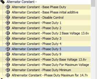

    Am I missing something? I don't have duty phase 6 or 7

    weird??? Have you updated VF in the last 1-2 weeks?

    5,978
    Dave
    They have changed on the last update i believe.Base Phase duty from 30 and up i have bumped up to 94. Phase duty base voltage 13.6 is now used to make those changes.I have this bumped up to 102.398 That gets me 14.5 volts when warm and it will be 14.3 to 14.4 when cold has been working great for me. If you want more just adjust Base phase duty to 95 and raise phase duty voltage13.6 up from 102.398 then check your voltage output at the battery or i use my scanguage to check it it has been steady at 14.5

    2020 MGM Tundra SR5; 2020 4R TRD Pro; 2008 4R SR5 v8
    They were renamed. You have what you need

    Awesome. For now I will just mess with Base Phase Duty and Phase Duty Base Voltage 13.6 settings.
