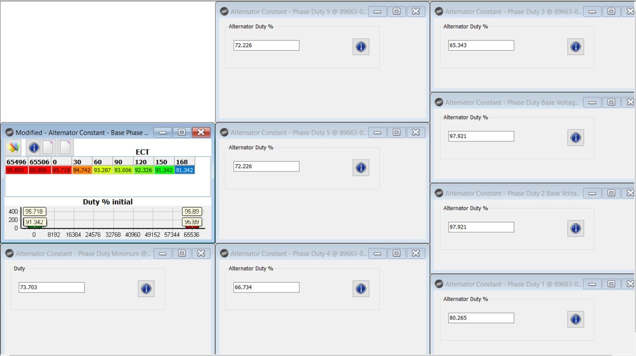

    Here is the updated voltage tables based on the 14.4v optimum, as well as the 13.2v floor, which I set to 13.3v for a fudge factor.
    Additionally, I believe the maximum mechanical output of the stock alternator is 14.8v (Possibly 14.7v, getting conflicting answers), so anything above that is going to max at 14.7v or 14.8v regardless of what values are set.
    Temp (C) | Voltage
    -40 | 15.57v
    -30 | 15.39v
    0 |14.85v
    30 | 14.31v
    60 | 13.77v
    90 | 13.3v
    120 | 13.3v
    150 | 13.3v
    168 | 13.3v

    Yes, those are the signed values of those numbers.
    I'm going over the numbers and wanted to point out since the alternator has a max mechanical output of 14.8v (or 14.7v), there's probably no harm in overshooting your numbers if you're looking to get max voltage, but there IS harm in going too low, as it will potentially wreck your AGM battery if you try to charge it with anything less than 13.2v for any significant period of time. That said, if your engine bay is exceptionally hot, overshooting could cause harm as well... but with the cold weather approaching, I'd bet it's safer than undershooting at the moment.
    As a secondary side note:
    I did accidentally flash without updating the Base Phase Duty table, and only updated the individual duty boxes. My output voltage didn't change... so it would seem that the only thing affecting the output was the duty table (the one with the colored boxes) ... which brings up many more questions.

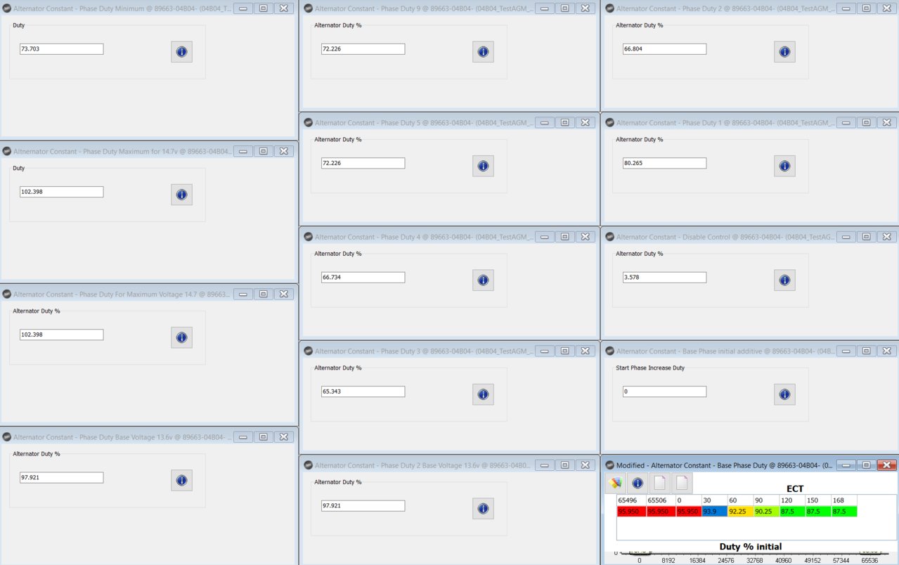

    Yep, here you go. I just updated my tables to reflect what I think will be proper voltages based on temp. I haven't been able to test them other than at idle though, but ambient is about 15C, and voltage at the battery terminals is right at about 14.28v. I suspect engine bay temp is reading higher than ambient though, so that tracks with the slightly higher than desired voltage based on ambient.
    I'll need to drive it tomorrow to see if voltage drops/raises accordingly. Also, my engine was warm by the time I zeroed in on these numbers, so a cold start in the morning should give me more data to work with.
    60 and 90 are just a best guess though. 120-168 are also best guess at keeping it above 13.2v, but there's probably some room to play with in there.
    I suspect my Base Phase Duty numbers would shift if my Duty cycles were stock, but since I altered them already based on @banjoist13 , I just left them alone and I'm trying to adjust the output only with the Base table, which seems to be working.
    This is for my 2017 04B04 ECU, so your results may vary.

    Base phase duty is what changes the voltages. The individual duty tables need increased to get to those higher voltages.
    If you just increase base phase duty, you’ll have to go higher, or wont get the numbers you want.
