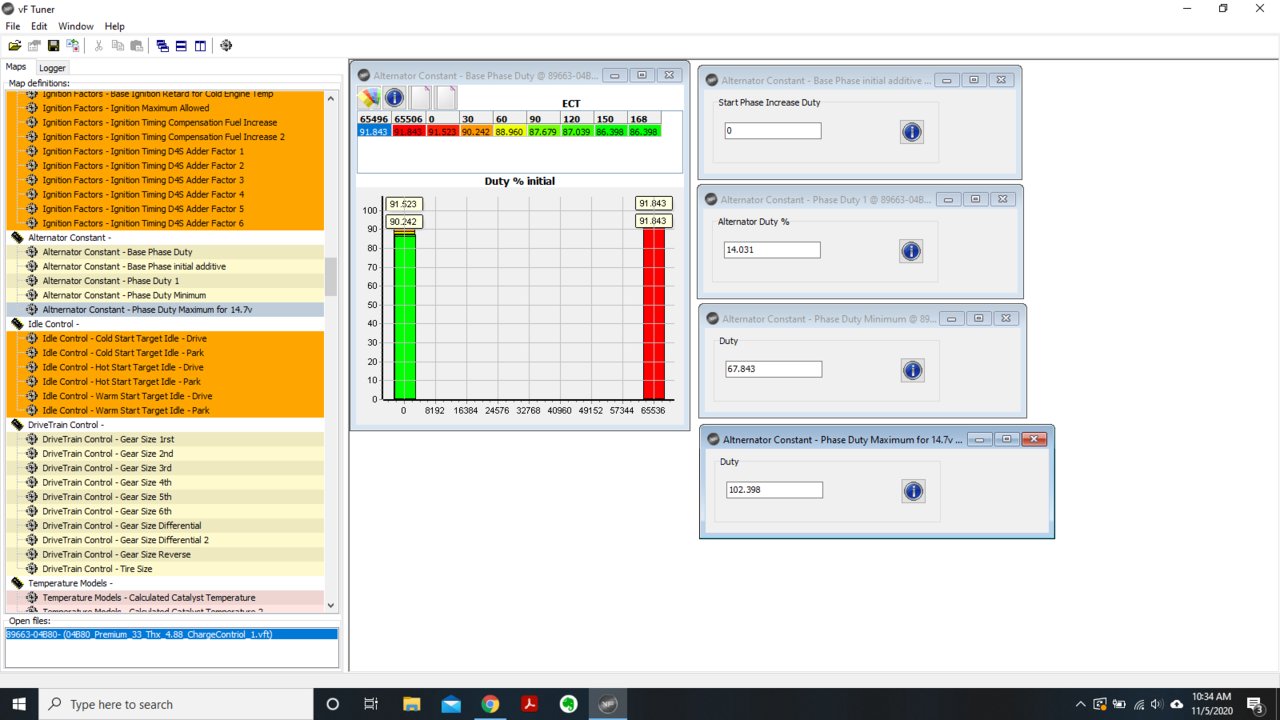

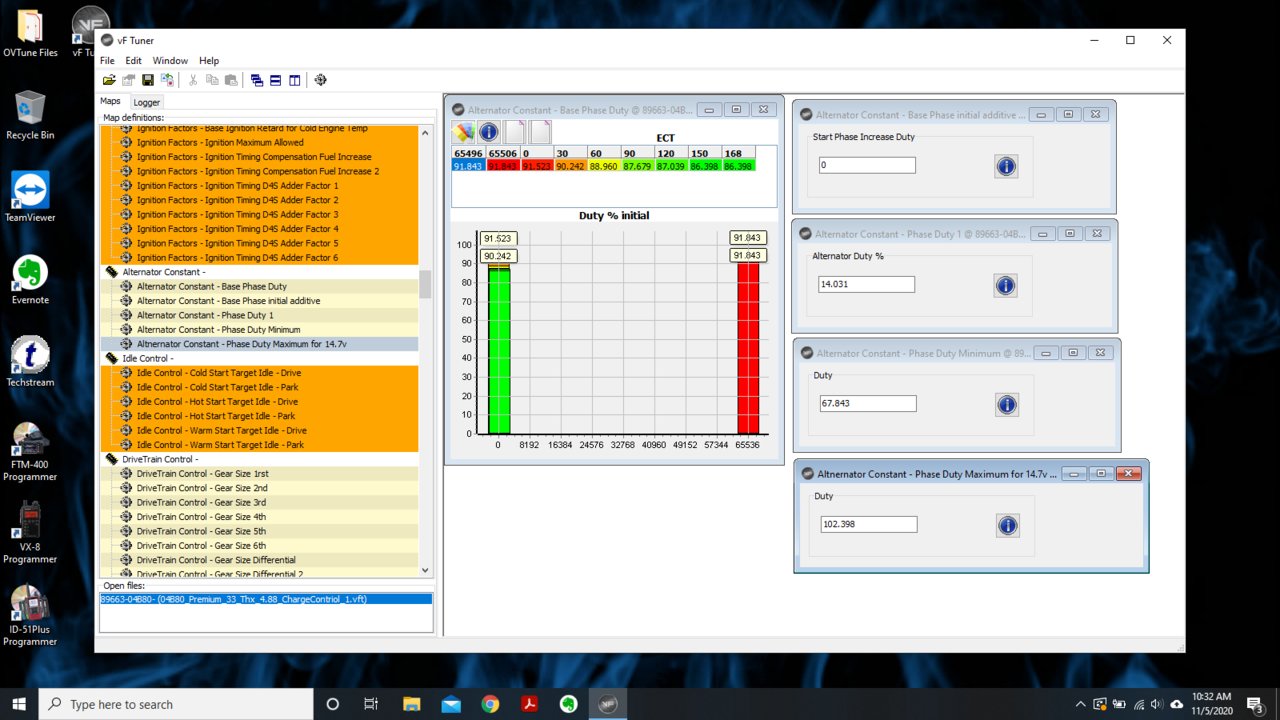

  8. Nov 5, 2020 at 8:36 AM
    #108
    Boltripper
    Boltripper Well-Known Member
    Nov 19, 2019
    #311136
    468
    John
    Hoover, Alabama
    2020 TRD Off Road Access Cab A/T in MGM
    Khaya Camper with Custom Mods - BP-51's, 4.88's, 33's', Dissent Offroad Front and Rear with Bud Built on the sides...
    So this is what I show table wise for a 2020 Tacoma with 04B80 ECU... Seems I don't have as many tables as the earlier years. Any thoughts on what I need to change?
    I'm running Version 1.2.7.0 of VFt
    In looking @Shellshock post for the Interstate, I'm assuming I leave the everything alone other than the table for Base Phase duty?
    I also believe that as the temp increases the voltage needs to decrease going into the battery. So perhaps the "94's " should be on the lower temps and decreasing as we move to the 168 Cell?
    Thanks in advance,
    John

  9. Nov 5, 2020 at 10:23 AM
    #109
    SpeySquatch
    SpeySquatch Function over Form
    Mar 6, 2018
    #246516
    7,366
    2016 TRD OR DCSB
    C4Fab LoPro, BAMF Sliders, Ext ADS 2.5’s, 4.88's, OVTune (OG to KDMax)
    Please do because certain people's tune files contain up to Phase Duty 7&8 where other do not. Would be nice if someone could make a handy spreadhseet for various scenarios :rolleyes:
  10. Nov 6, 2020 at 8:45 AM
    #110
    SpeySquatch
    Mar 6, 2018
    #246516
    7,366
    2016 TRD OR DCSB
    Does anyone have a screenshot of the newest VF Tuner alternator settings for AGM? Seems some of the Phase Duty fields no longer exist. Jumps from 6 to 9 in the base phase duty and I am unable to accurately assign values. Please please please

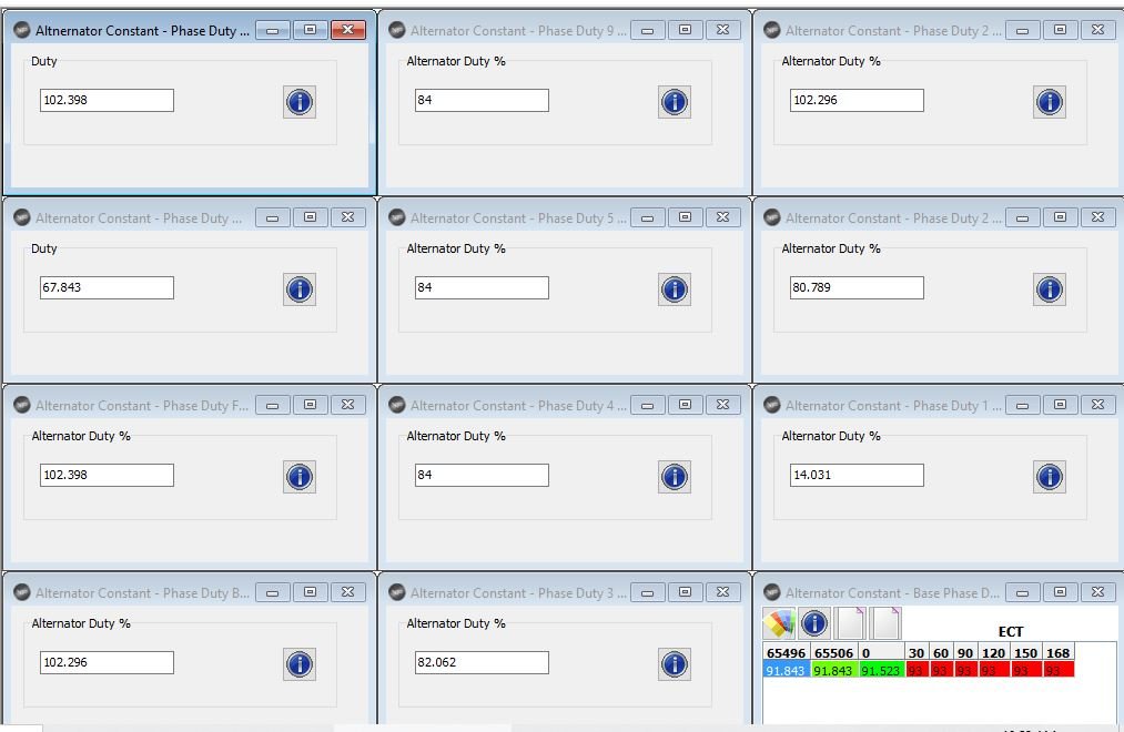

  11. Nov 6, 2020 at 8:53 AM
    #111
    uploadadventure
    uploadadventure It’s all @ColoradoTJ’s fault
    Jan 30, 2019
    #281288
    9,872
    Dixon, Mo
    2019 Cavalry Blue Tacoma TRD OR (sold) 05 Duramax
  12. Nov 6, 2020 at 5:37 PM
    #112
    Ray1989
    Ray1989 Well-Known Member
    Sep 30, 2017
    #231592
    190
    SoCal
    3rd Gen Sport
    Post Updates after a week see if any issues occur with urs. Thanks my issues was with the Check Charging System when i would slow down

  15. Nov 6, 2020 at 8:32 PM
    #115
    uploadadventure
    Jan 30, 2019
    #281288
    9,872
    Dixon, Mo
    14.3/ 2
    I didn’t want higher than that.
