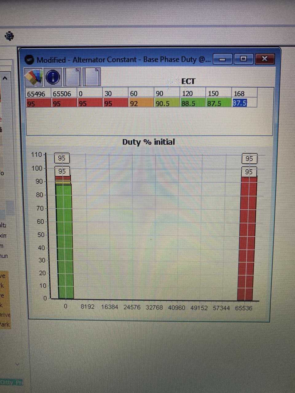

    I was able to flash a few changes at lunch and have some information.
    65496 (-76f) 65506 (-22f) 0 (32f) 30 (86f) 60 (140f) 90 (194f) 120 (248f) 150 (302f) 168 (334f)
    Stock 91.843 91.843 91.523 90.242 88.96 87.679 87.039 86.398 86.398 = 13.8 v Resultant (At Driving Speed)
    Change #1 96 96 96 95 92.5 90.5 88.5 87.5 87.5 = 14.8 v Resultant (At Driving Speed)
    Change # 2 95 95 95 95 92 90.5 88.5 87.5 87.5 = 14.7V Resultant (At Driving Speed)
    I was able to see the charge voltage drop from 14.7V to 14.6 when coolant temps finally reached 188*F to 190*F
    Charging Voltage then dropped to 14.4V - 14.5V when the ECT was reading 199*F - 202*F / IAT's remained 88*F - 92*F
    My initial logic would have called for IAT to determine battery temperature within the engine compartment, but looks like the ECT (Which is listed as the factor in VfT) is the variable. More testing is needed....
    A few items of clarification on the thread IMHO:
    • Charge Voltage needs to decrease as temperature increases. I haven't found any AGM literature that shows otherwise.
    • I had a National Luna Dual Battery kit in my 80 Series and it would disconnect the 2nd battery when my IAT's hit 180*F (Sitting in summer traffic) - I talked with NL AUS and they stated this is a safety feature to not destroy a battery when it over temps. I would recommend that you follow the stock Toyota map of decreasing charging voltage as temperature increases. I would not do a flat value across the entire temperature threshold.
    • Lastly I do not believe that the temperature sensor is the Ambient Air Sensor. The testing today shows otherwise, but I'm still looking for a list of all sensors in the Tacoma that can measure temperature.. They might have snuck something in there, but I'm not sure..
    Hope this might help someone~
    Cheers,
    john

    @OVTune
    There are many theories in this thread.
    Are the axis values for ECT Fahrenheit or Celsius?
    Are the axis numbers for ECT:
    Engine Coolant Temperature?
    Engine Compartment Temperature?
    Ambient Air Temperature?
    Something Else?
    Is the developer still going to fix the Negative Values?
    Or can you confirm what the values should be (-40 & -30 or *** & ***)?
    Maybe a negative number will not work properly. I am ok with 65496 and 65506.

  6. Nov 10, 2020 at 4:36 PM
    #146
    OVTune
    OVTune Well-Known Member
    Mar 27, 2017
    #214557
    8,112
    OVTune
    ECT is engine coolant temp
    Values will always be in Celsius.
    Yes we will get neg values fixed.
    Furthers value is -40.

    Getting started with some tuning in vF. My first attempt is the AGM adjustment. Looking like people are dialing it in to adjust with temps. Kudos to the genius’!
    can I get a quick quality control check before I flash? since I’m brand spanking new to vF? Do these values look right for a 17? I’m running a northstar, so charging voltage should be 14.4-14.8 at 77 deg F.
    Do I need to adjust any other tables?
    thank you @Boltripper for your work!

    Dave
    What ECU is it 04b04? 30 and up i have set at 94
  17. Dec 1, 2020 at 2:46 PM
    #157

    5,957
    Dave
    You also want to change the Phase duty2 base voltage 13.6 up to 102.398 and up Phase duty base voltage 13.6 to 102.398
    I get a max 14.5 and a low of 14.3 works great for my northstar 31
