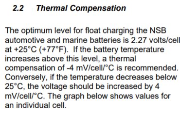

    Battery charging from the alternator should also be based on the charge level of the battery, not just the ambient temp. Although the ambient temp will affect ALL charging states. If you keep charging a lead acid battery at 14.5 volts and it’s fully charged, it’ll start to boil and affect battery health. At some point, the ECU will see that the battery is full, and go into a float mode to maintain a good charge. Float charging is generally around 13.5 volts for a 12v battery. These voltages drop as the ambient air temp rise and conversely for lower temps.
    I’m wondering if people experiencing the alternator charging voltage dropping to mid 13v when they come to stop , or an idle, is a result of the ecu adjusting voltage from a cycle charge to a float charge.

    FYI just found this: https://masterbattery.com/wp-conten...-Automotive-and-Marine-Application-Manual.pdf
    By my math, at 25C the optimum float charge should be 13.62V. Not sure really how to handle float charge with the VF tables.

    I just verified with Northstar float voltage for AGM batteries:
    13.6V @ 25C +/- 18mV per C change, but NEVER lower than 13.2V under any circumstance.
    As Tacomarin said above, though, not sure how to handle this in the tables though. We need a float table and a charge table really.
