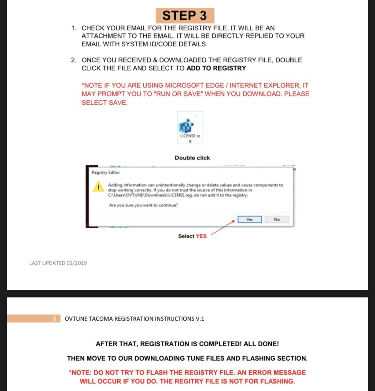

    Rafael, I just received my email from you with the vF program and master key number. Since I’m an existing customer, do I still need to email you my system ID or does that just transfer over to vF?

    Just got my VF code!! I assume this is different than the flash manager registration though, correct?
    For those of us that traded our dongles in can we use flash manger to flash the .p5f files before VF tuner is available?
  20. Apr 23, 2020 at 12:07 PM
    #20
    dskakie
    dskakie Well-Known Member
    Jul 19, 2016
    #192352
    969
    Dan
    Northern CA
    2016 TRD OR DCSB
    I don’t think we can flash p5f until the registry key is applied. So still waiting as far as I know
    edit: step 3 of the instructions
