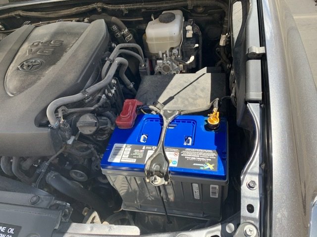

    I just installed this, vF key in hand, ready to install. So stoked for everything vF opens up. Also really need to clear the dust from my engine bay...
