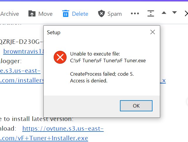

    I'm no expert here but try a few things:
    1. If it's not even letting you download it from the browser, try another browser like internet explorer, mozilla, etc.
    2. If you've downloaded but can't install, try right clicking and hit "run as administrator".
    3. Lastly, right click on the start button in the lower left hand corner of the desktop. Navigate to Windows Powershell (Admin), which will open a command prompt. Copy and paste this command into the command line: "net user administrator /active:yes" (without the ""). Keep the command line open and try installing software. Whether it works or doesn't work, run the command: "net user administrator /active:no" (without the "") when you're done.

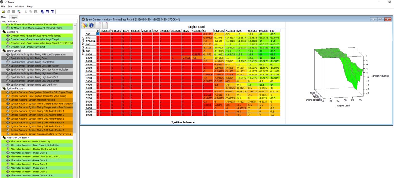

    Some new tables coming to vF Tuner for the AUTO and MANUALs.
    (also all the TCU tables in development)
    base ignition retard (base values used to retard from base ignition tables in calculating ignition final)
    So if you're wondering why your logged ignition differs from table ignition, there are compensation factors in place like this, which reduces from base
    We also found 4Low RAM controls. Testing if this is just the 4Low controller telling the ECU, or ECU telling the 4Low controller.
