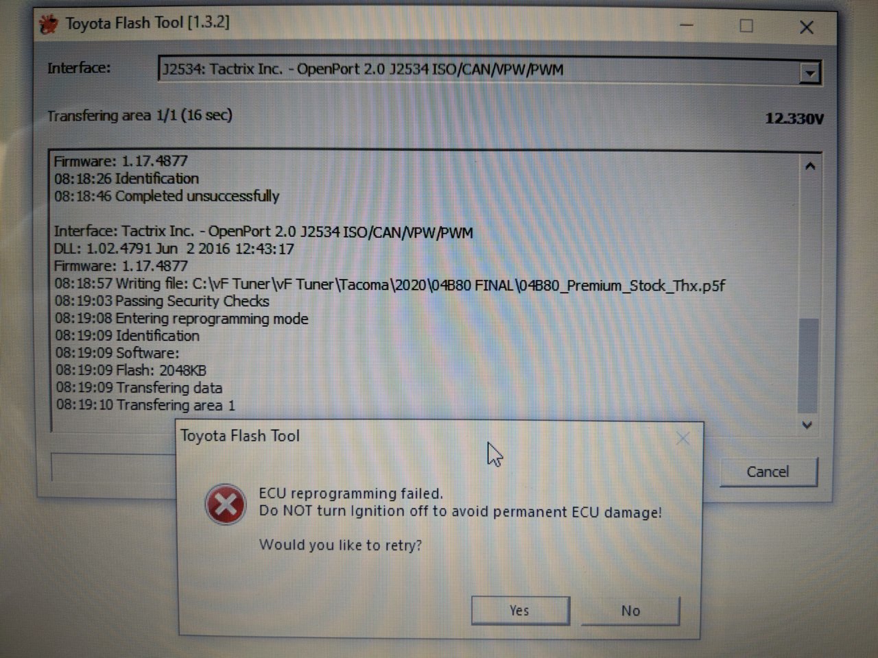

    Well I disabled firewalls and real time protection, opened vftuner and clicked the flash tool. Put the vehicle in the on position. Plugged the cable in, and hit flashit. Selected the file and it always seems to generate this error. I searched the forum and found that someone said they disconnected the battery then tried again and it worked. Not for me. If anyone has a suggestion I'm all ears. I'm sure I fucked something up somewhere :confused:

    I know this probably sounds dumb but make sure the A/C, radio, and all lights are off. Not sure if that is what's causing it, but worth a shot if that stuff isn't already off just in case the battery voltage is dropping.

    Gonna double check everything and try again
    :fingerscrossed:
    Nope, fml
    Can't even flash back to stock, fml. At the mercy of a fix before I can even drive :eek:

    Sometimes clearing dtc then turning off then trying again will work

    Heading out to try that now. Really hoping it works.
    Nope didn't work. Took a little longer to get to the error but still failed.
    Once I clear DTC it can make it to about 40% complete then fails

    The DTC read and cleared successfully so still unsure what the issue could be.

    OMG I got it to work.
    I was plugged into a USB 3 port when I was having issues. I changed the virtual machine USB controller settings and enable the compatibility to USB 3.1. that is what ultimately made it so that it would go to 50ish percent before it would fail. Then I realized I had a non-USB 3.0 port on the computer and when I switched it to that it was successful.
