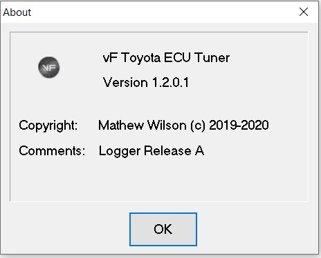

    what’s the new version number?

    I downloaded the same and thought we'd have editable 2.0... I can't see it anywhere.

    You need your specific ECU tunepack to be able to edit anything other than the stock tune file. Some have not been released yet.

    Ignore the version number you see while the software is installing...
