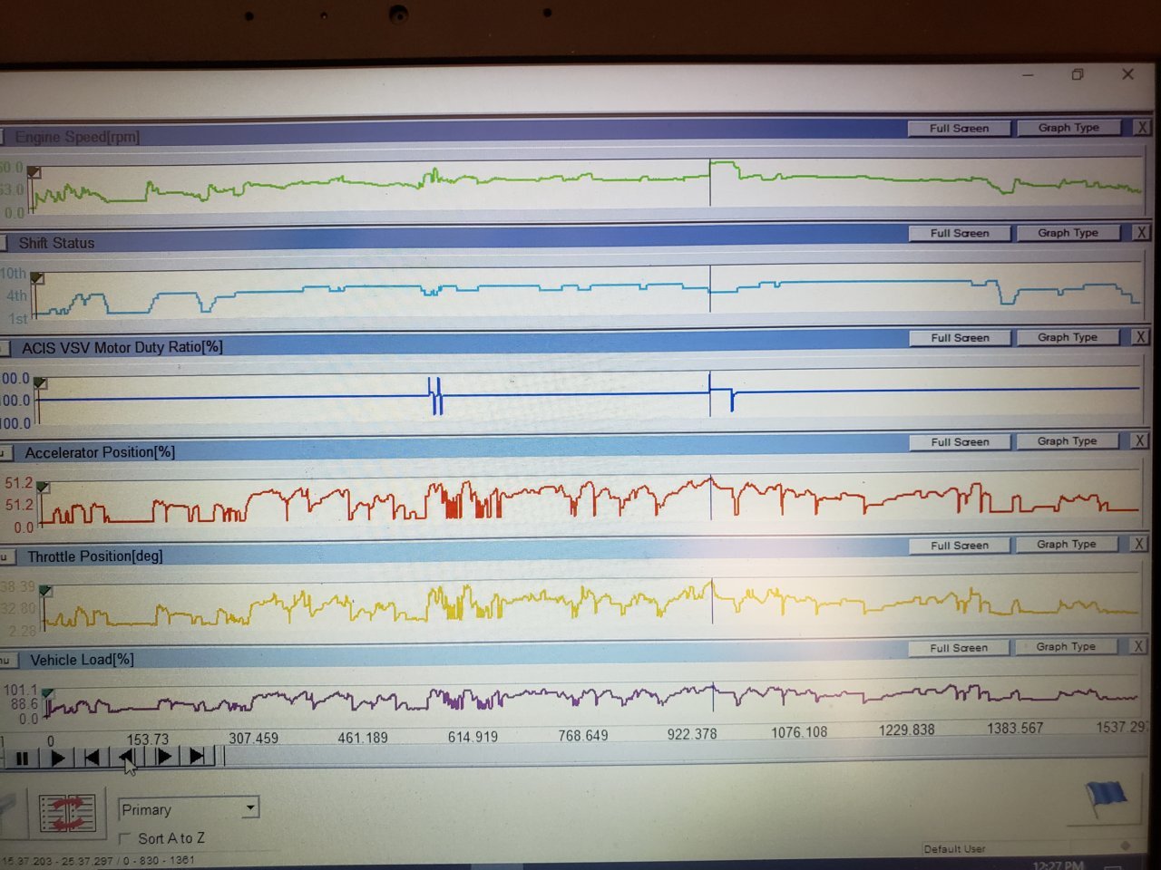

    Yes. At the end of the climb on the top of the hill
    Throttle drops from 36.8 to 21.8 deg (accelerator from 50 to 36%), load% goes down, but rpms are getting stuck @3200.
    Used to have it on b03.
    See right of the vertical line.
    Thanks

    Victory sliders, SSO slimline w/ stage 2 high clearance and winch/heretic 30”, 285-75r17, cbi bedrack, wheeleveryweekend rtt, Morimoto bi-xexon, morimoto 2-stroke hi’s, morimoto rocklights, ov tuned, expedition essentials TPAM, full chrome delete, 12volt remote start w/ viper cellular module, custom mid-skid plate, view-sonic anytime front and rear cam, pop-lock tailgate lock.
    Looks like you down shifted at top of hill

    2017 White SR5 DCSB V6 4x4
    Got to the top in 4th, tc locked. Which is appropriate for the grade.
    Started backing off of the pedal , but the engine was not responding the the throttle reduction for 20 or so seconds, staying in 3200 range.
    Once I let the pedal go( accelerator went to 0%) and press again, the tranny upshifts to 5th.
    ACIS suspiciously stuck at 17%..

    C4Fab LoPro, BAMF Sliders, Ext ADS 2.5’s, 4.88's, OVTune (OG to KDMax)
    I’ve had this happen a couple times as well and used S mode to get out of it

    Issy, WA
    Yeh, I'm getting it every time in those conditions on 2.0. I'm sure if I drive slower it would not be a factor. So it is on my to do list..

    2016 Black Tacoma Sport 4x4 V6 DCSB AT Loaded
    KDMaxPro 10.0, OME 2" Med Duty lift, RCI Sliders, RoofRack, Skid Plate, etc.
    This happens to me every day on my work commute (at highway speeds). It will not upshift until I crest the hill, even with less pedal. I haven't let all the way off the pedal though with other cars up my butt. Might be a catch22 tho as the alternative may be gear hunting. Let us know what you find?

    St. Louis, MO
    So. Many. Stickers.
    why on earth would they program the transmission to up shift when your foot is in it and you're going up a hill? Think about it fellas, it's got to stay in gear to keep the power. Up shifting into overdrive or your second overdrive gear is not a great way to keep power down.

    Issy, WA
    That's the issue.. the foot Isn't in, but it keeps revving like a mofo.
    Forget about upshifting

    2018QSDCLBSR5
    Enhanced Skinny Pedal
    I don't know, but mine up-shifted all the time going up hill with my foot in it when I was on the stock tune! Like it was rationing rpm's or something, maintaining speed be damned.

    2,829
    Adam
    Marin, CA
    17 DCLB
    list is growing fast
    I’ve felt that “rev hang”, I used to get that hang up on 04b03 stock tune, but it stopped when I got 04b04 and it does not do it for me on 2.0 33’s thx tune.

    711
    2018 Cement Tacoma TRD Off-Road
    This used to happen to me with the stock tune as well on my long commute to work. I don’t have that long commute anymore so I can’t say if it’s doing it with OV Tune though. I’d crest a hill in 4th gear with cruise control on, engine would still be 3200 and it wouldn’t shift to 5th even though 4th gear clearly wasn’t needed anymore. It would hold 4th gear for MILES sometimes, when completely unnecessary. I found if it was holding 4th gear for too long, any input on the gas pedal caused the transmission to upshift to 5th, even with the cruise control still on. Just the slightest little touch of the gas pedal and it would upshift. Very weird. Toyota totally dropped the ball with the 3rd gen transmission. Without OV I would definitely not keep the truck long term.

    23,413
    Iowa
    It sounds to me like you guys are talking about the truck not wanting to upshift and holding a lower gear than you think it should. This is not rev hang, this is something that needs to be adjusted in the shift logic.
    Rev hang is on the MT and something us MT guys have talked about for a long time. When you clutch in, the ECU will hold the revs and slow them from coming down. The revs will hang instead of falling.
    These are two very different things, lets not use the same name for both of them and get everyone more confused than they already are.
