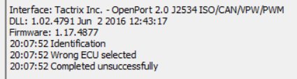

    Alright, its finally my turn. Picked up a cheap windows laptop, working on getting everything installed.
    I've made it to registering my software, which it appears to have done successfully. But now the software won't open. When I attempt to open VF Tuner I get this error message. Any input?

    Vlady Well-Known Member
    Dec 20, 2017
    #238986
    4,703
    Issy, WA
    2017 White SR5 DCSB V6 4x4
    Add c:\vF Tuner to exclusion list under Windows security and try again

  11. Jul 15, 2020 at 3:31 PM
    #2651
    Max713
    Max713 Well-Known Member
    Nov 29, 2013
    #117569
    629
    Max
    Eugene, OR
    2017 MGM TRD OR
    Wasn't able to figure out how to do that, but I tried opening the app again and got a security notification. I was able to manually override there. On to the next step!

  12. Jul 15, 2020 at 3:38 PM
    #2652
    Vlady
    Dec 20, 2017
    #238986
    4,703
    Issy, WA
    Google it.
    Also add .exe for pf5flash.
    You will have the issue to start it as well
