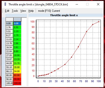

    Reg is the starting octane. All tunes are Octane Learning.
    THX:

    So THX in the tune names lets us know that the Throttle has a certain amount of expo added which changes the throttle curve, hence the throttle curve is no longer stock.

    The OVT throttle curves are not stock to start with. THX adds a bit more in some areas, but not at tip in.
    The best thing to do is try both versions to see what suits you. Give it at least 500mi unless something really odd is happening.
