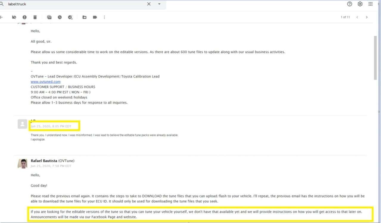

    It should be noted, that not all the manuals have editable tune packs. I don't know how many do at this point. But as of this post, I only have the stock 04A70 tune as editable. Here is a conversation I had with Rafael. Granted, it was a month ago, but I have not seen the pack for this ecu released yet, and I did not see it in the latest update.

    It’s there a TSB and 04A71? I think 71 has a tune pack.

    There is, but at the time it was still flash manager and my thinking was that I didn't want to bump my ECU and re invest for all the tunes. For now I am happy on SFOB 87 while I wait for editable versions for my ECU. Plus I get to the advantage seeing the development process from the other members working out all the details for the charging voltage and throttle tables, etc. in the mean time.
