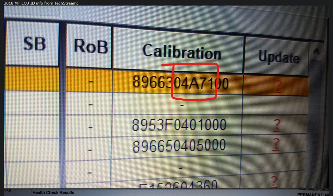

    Allrighty, silly question but here goes......
    What do 04B02, 04B03, 04B04 refer to?

    ECU revisions
    CygnusX191, tacocart762 and tonered like this.

    Randy
    Traverse City, Michigan
    So those are Toyota numbers?

    wiljayhi
    wiljayhi “..ain’t nobody’s business if I do…”
    Oct 8, 2018
    #268685
    2,635
    Jim
    Murky Water, MB, eh?
    3G, Tuned
    yes
