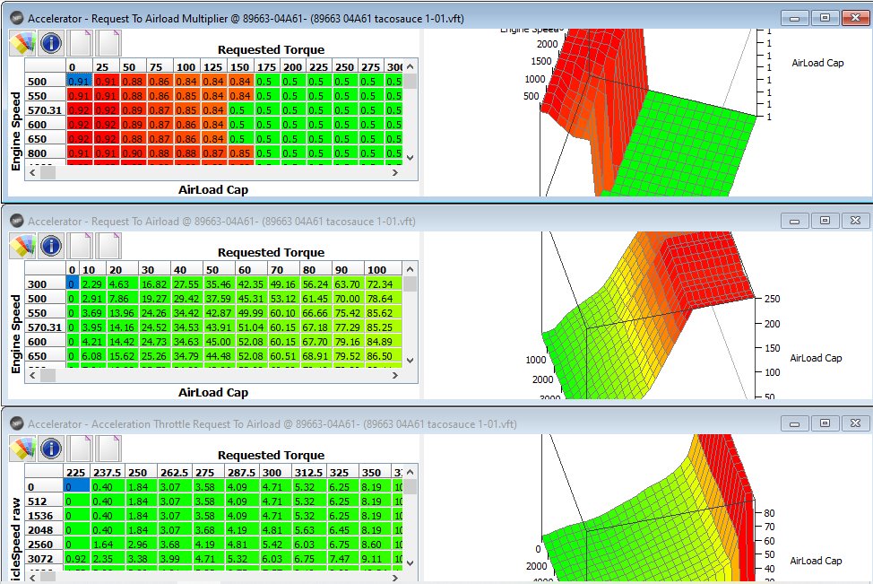

    first 2 tables don't need modified,
    The last table directly will change how much throttle allowance can be given. So raising values in that map = more throttle
    do not change the high values (in red) though.

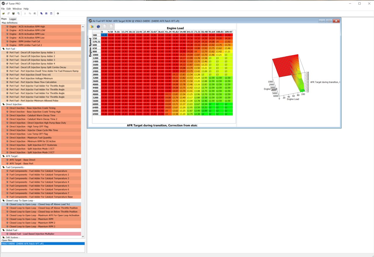

    An update to vF Tuner is available.
    this update is not required.
    Also, vF Tuner Pro Tuner Upgrade users / shop now have exclusive tuning features including
    - ECU Locking (protect your tunes)
    - File locking (vF Tuner users cannot access it)
    - Custom Coded AFR Table for ease of tuning.
    You can use this AFR table to get the AFR you want! That's it. Set it up, and as long as airbox is stock, injectors are stock, the ECU will do it's best to maintain the targets you set.
    this makes fuel tuning much, much simpler.

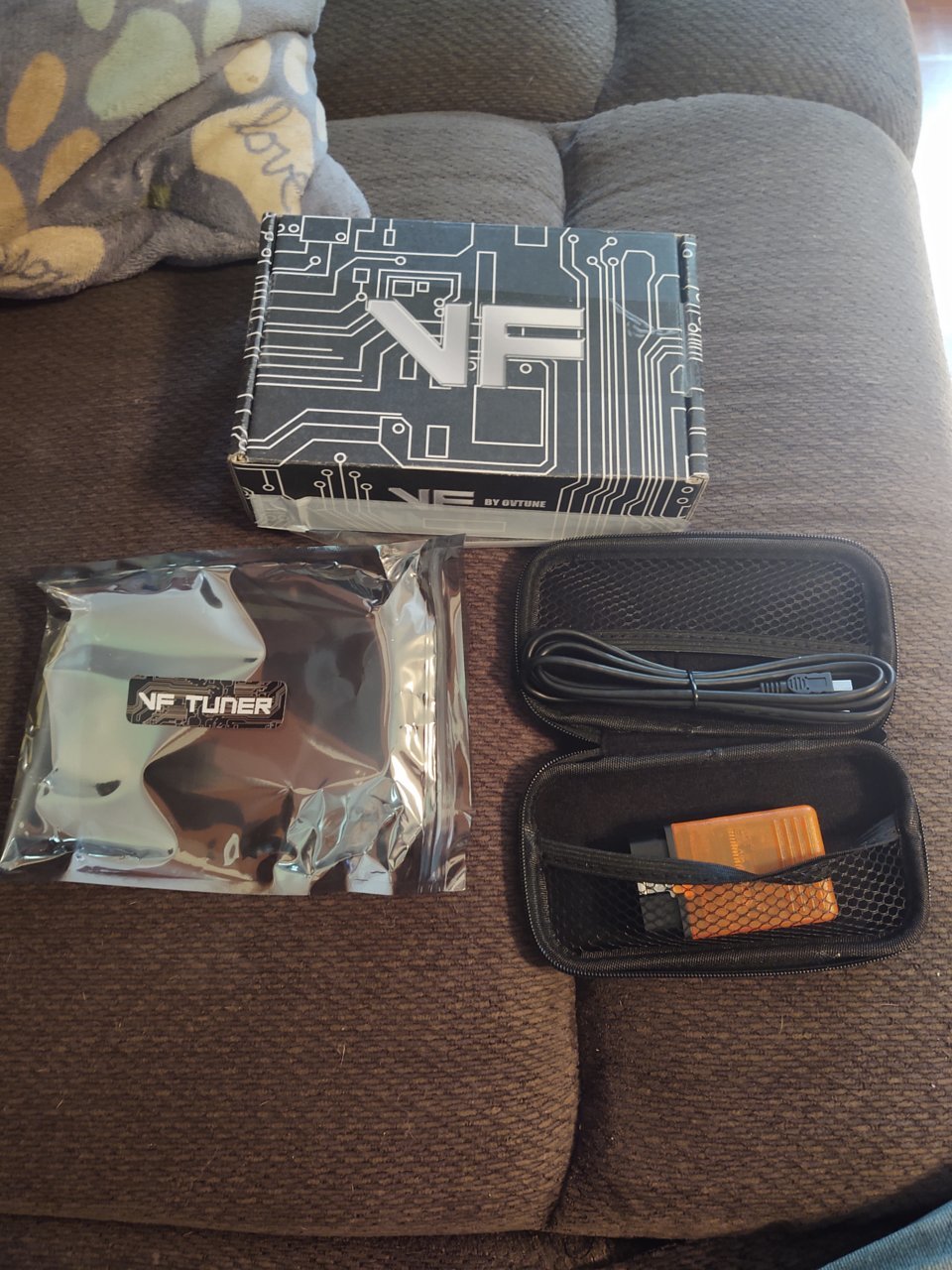

    I need help
    I'm stuck at the master key stage, and I thought I bought the handheld tuner thing. I'm so f*cking lost right now. What do I do?
    Anybody with time and patience???

    There are no more handhelds. Only a few people have those and they were not for sale for over a year.
    Have you seen the vF Instructions? They are here, under the Resources menu on the OVT site:
    https://cdn.shopify.com/s/files/1/0885/5830/files/vForest_Tuner_Instructions.pdf?v=1592182954
    Let us know where you're stuck and we can get you going.

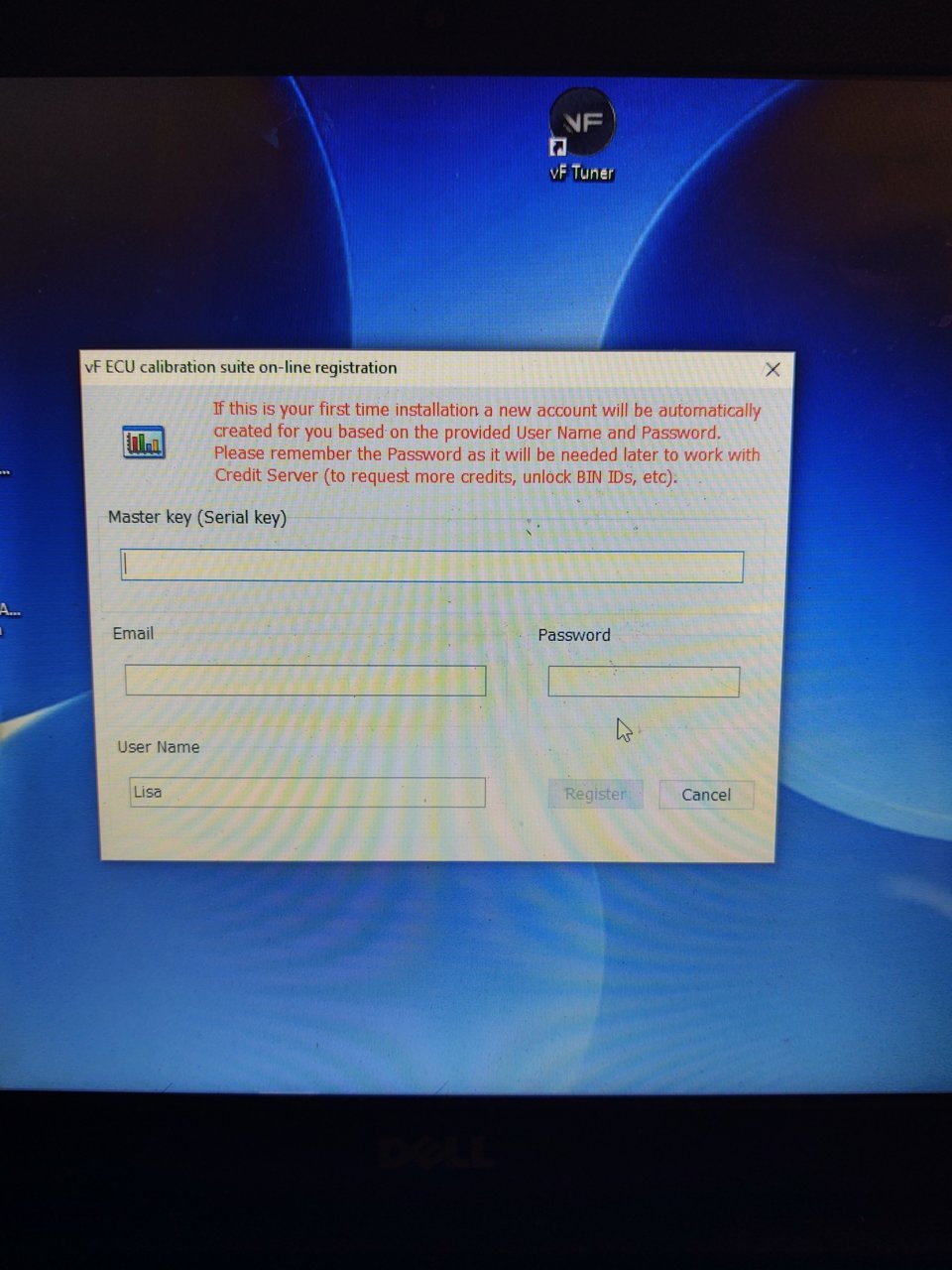

    The Master Key comes as an email automatically from your order. Did you get that? Be sure to check your SPAM folder since at least Gmail has been wonky lately.

    Found in spam! Now it's not recognizing Master Key (email)

    Excellent!
    If you have no spaces in the username that you chose, then you will have to contact @OVTune . Just reply to that email with your problem.
    You should be tune soon.

    Do I type the dashes in the master key?
    Thank you so much for your time!!

    Yes! You can just copy and paste it from the email as long as you don't include any extra characters or spaces.
    No problem at all.
