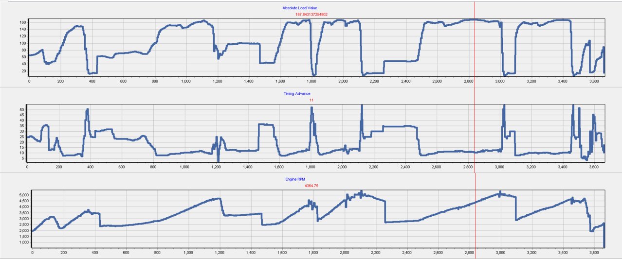

    vF Tuner exclusive 2GR-FKS Load patch allows for the engine to calculate a load cap higher than stock limit of 158%.
    Now Load can be calculated up to 255%.
    Here is a log with load peaking 167% (with boost).
    D2H, tacocart762, e46_ema and 6 others like this.

    What does this mean?

    I think its more applicable to boost but this is from an unrelated resource:
    Max Load adjustment tuning can compensate for how much air (gram/cyl) the ECU will recognize. This is a critical parameter for higher HP applications due to the fact that the ECU is not able to properly calculate fuel requirements when demand exceeds the load cap. If the load cap is set too low, a lean condition occurs, getting worse as the delta of actual load goes further beyond the load cap.
    I do wonder if there is any benefit for non-boosted applications @OVTune
