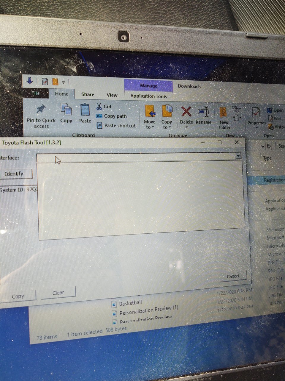

    It looks like you have not installed the drivers. In FM, do these steps:

    I
    I don't have to pull my stock file or nothing???

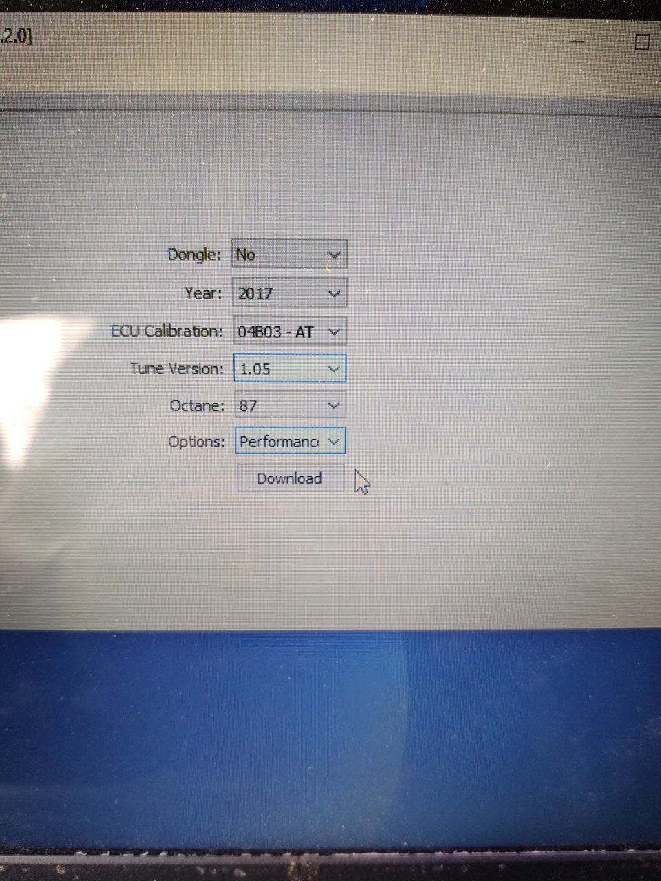

    So I choose no Dongle
    My model year
    What ECU calibration??? Any
    Then Tune version 1.05
    Octane 87
    And performance
    Then click download with the truck on but not running?
    CygnusX191 likes this.

    Did you get the drivers to show up?
    There are full vF instructions on the OVT site under resources. I would link them, but my phone is not showing me the resources page.
    Don't bother with 1.05. Used the 2.0 Base versions here:
    https://www.ovtuned.com/blogs/news/tacoma-2-0-final-auto-release

    Ah! It looks like you are in.

    Yes. 2.0 is not released in FM yet. For now, you need to use that link.
    It depends what your ECU is. Click Identify.
    If you are not 04B04 (latest for your MY), consider flashing the TSB from the thread in my signature.

    So I think what happened is I uninstalled FM and VF tuner. I'll now reinstall VF set it up. Click identify. Then choose my proper 2.0 files based on the link since they aren't finalized in FM yet... Correct?

    Lynnwood, WA
    Yes. That is it for now.
    Note though that you can have current working versions of both FM and vF at the same time.
