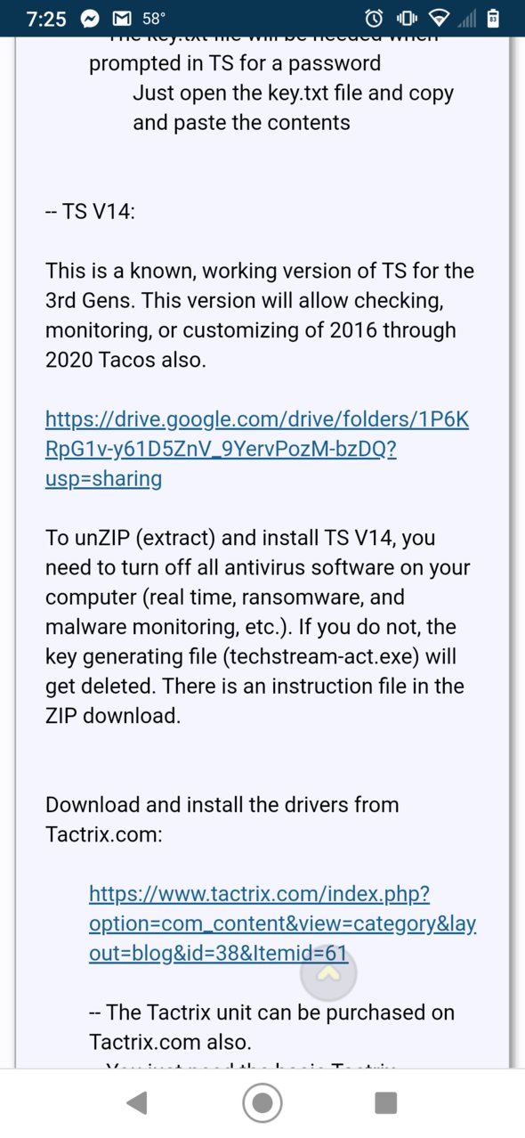

    Screenshot_20200812-072518.jpg click on both or just top one? Again I'm NOT smart . I also GREATLY appreciate your guy's time!

    #231055
    31,331
    tony
    Lynnwood, WA
    You already have the Tactrix drivers installed and working from OVT.

    So just click the top link, flash my truck with that, then download the 0VB04 version of the OVTUNE and I'm golden? Do I need to flash back to stock 04B02 first, or can I proceed from my current tune?

    No need to flash back to stock, just flash from whatever you are on.

    Clicking the link will not flash your truck. It is a download file for TechStream that you have to install and activate using the license key generator.
    Turn off all of your antivirus software before you open the ZIP file and until you have TS activated. The license key generator program gets flagged up, but is harmless.
