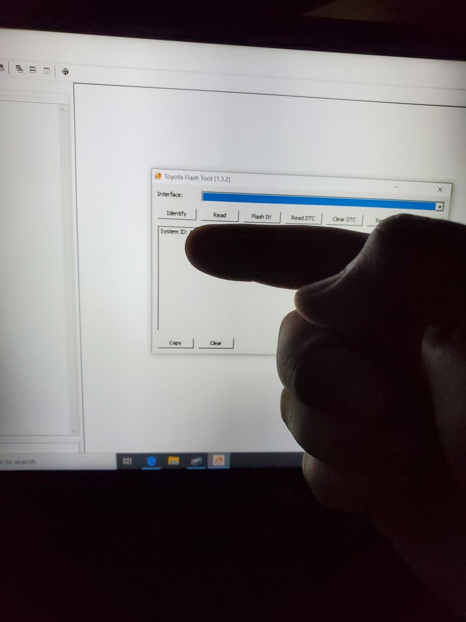

    why does my drop down screen (interface) look blank here? should say tactrix open port 2.0 or something to that extent. also, after i press identify it just closes the flash tool and nothing happens. any insight?
  15. Aug 25, 2020 at 6:35 AM
    #3435
    OVTune
    OVTune Well-Known Member
    Mar 27, 2017
    #214557
    8,112
    OVTune
    install tactrix drivers

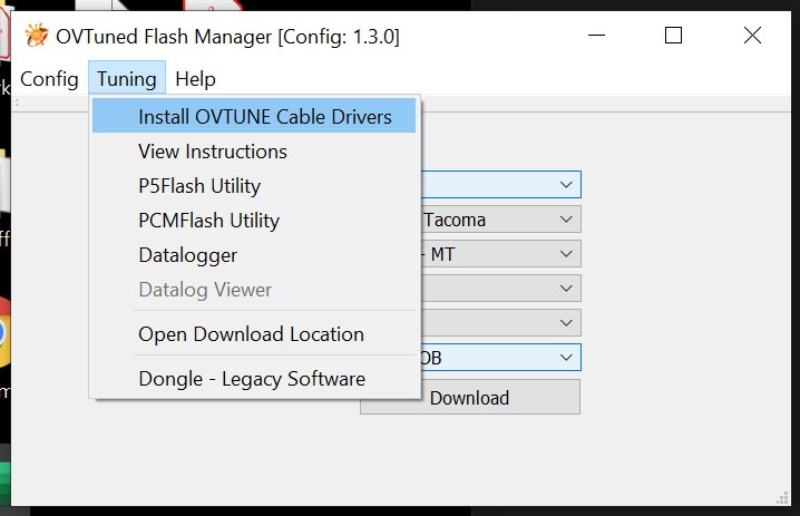

    i just sent out the email with all that calibration and order numbers and what not. but i dont even see those options you have pics of lol.
    tonered likes this.
  19. Aug 25, 2020 at 7:04 AM
    #3439
    tonered
    tonered bartheloni
    Sep 25, 2017
    #231055
    31,203
    tony
    Lynnwood, WA
    Sorry! I so used to Flash Manager. It is in there.
    I would recommend installing for access to other tunes:
    https://www.ovtuned.com/blogs/news/ovtune-tacoma-flash-manager-overhaul
    That is interesting though, because those updates in FM were important in the past. The vF side might not need them? Although, it is the easiest way to get the Tactrix drivers.
  20. Aug 25, 2020 at 7:05 AM
    #3440
    Shellshock
    Nov 21, 2015
    #170338
    23,417
    Iowa
    Thats basically why i install FM, it has all the drivers and stuff contained
