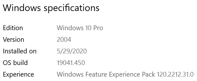

    Pfft! It grabbed some Win 1909 updates. The 2004 Coming notice wasn't there before the Updates and now it is back. Seriously. April 2020 Updates still dangling limply.
    Regardless, the Flash Tool is still happy.
    ihatemytruck, CygnusX191 and wahoobie like this.
  14. Aug 26, 2020 at 7:58 AM
    #3534
    wiljayhi
    wiljayhi “..ain’t nobody’s business if I do…”
    Oct 8, 2018
    #268685
    2,635
    Jim
    Murky Water, MB, eh?
    3G, Tuned
    I’ve got a download & install msg for the 2004 update but I’m going to wait for you to tell us that the sys ID didn’t change. You da man @tonered !

  15. Aug 26, 2020 at 8:07 AM
    #3535
    Shellshock
    Nov 21, 2015
    #170338
    23,443
    Iowa
    You guys have fun. I’m staying on 1703 lol
    ihatemytruck, CygnusX191 and tonered like this.

    I tried to see if I could force it, but it is still saying that it will come in a throttled roll out. For the life of me, I can't understand why my HP desktop at work would get it before my MS Surface would. LoL!
    I do apologize for not verifying the System ID on the HP before and after. Annnnnd, time for the sups dumb question, but where the hell is the Sys ID noted at, if I don't have OV software installed?? System Info, Win About, System, and the Registry do not seem to have a matching value? @Shellshock ?
    I'm happy to take one for the team if it doesn't upset @OVTune that the System ID rolls, again.

    I'm up to date and all is good, you'll be fine :thumbsup:
    ... maybe
    Edit:
    CygnusX191 and tonered[QUOTED] like this.
