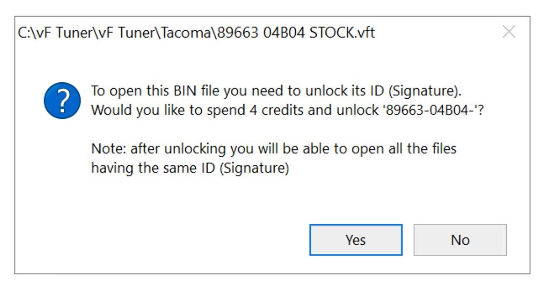

    @OVTune - Quick question. I am a registered user of vF Tune and today started playing around with the software. All good so far and wanted to get some clarification. I went to load the 'STOCK' 04B04 ECU .vft file and got the below prompt. My question is, if I unlock this ID, does 2.0 final have the same ID as the stock file? I assume when you 'unlock an ID' it means you are unlocking the ECU and have access to all future vft files *ONLY* for that ECU. (ID/Signature = ECU ID) If I buy more credits, it unlocks another Signature ID/ECU. Did I interpret that correctly?

    OVTune
    yes once you unlock that ID you will have access to any 04B04 files
    2.0 final will have the same 04B04, it's based on the ECU. it does not change

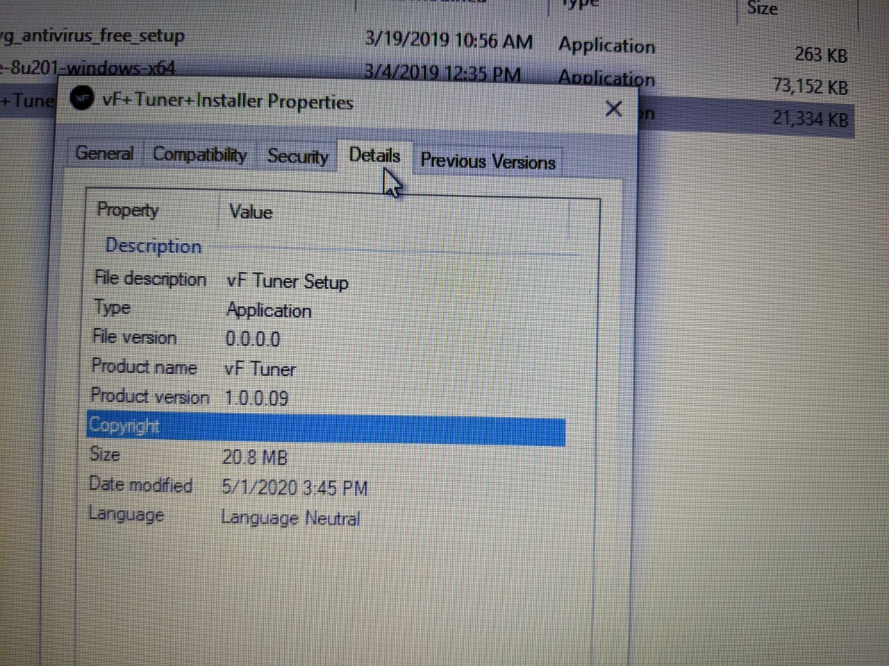

    i have now downloaded vF from your site 2 more times and it is not giving me 1.0011, i keep getting 1.009 every time. I have confirmed by going into the details tab. It is a 20.8mB file, not 46.7

  14. May 1, 2020 at 2:36 PM

    mZiggy
    mZiggy Honey badger
    Apr 8, 2017
    #215707
    4,709
    Marc
    2020 MGM Tundra SR5; 2020 4R TRD Pro; 2008 4R SR5 v8
    Right...I said that it still reads as 1.009 and is not the appropriate size file

  16. May 1, 2020 at 2:44 PM
    #356
    OVTune
    OVTune Well-Known Member
    Mar 27, 2017
    #214557
    8,112
    OVTune
  17. May 1, 2020 at 2:48 PM

    Just used the direct link
    Will try uninstalling vF completely, downloading again from that link, and then seeing what happens. If it doesn't work, fuck it, I'm not allowed to have vF and I already have 2.0 final anyway

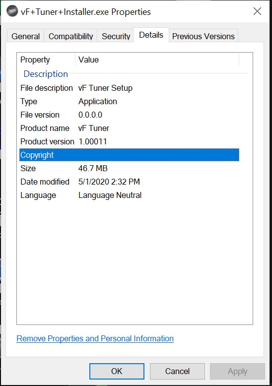

    OVTune
    Try exiting your internet completely.
    I just clicked that same link and it's 46.7mb

    20 MGM Sport
    Try another browser. Chrome did that to me. Switched to Edge and it was fine.
    thanks, that worked
    disconnecting from the internet and restarting the laptop and then reattempting in chrome still didnt work. Using Edge for whatever reason did. now to reinstall
