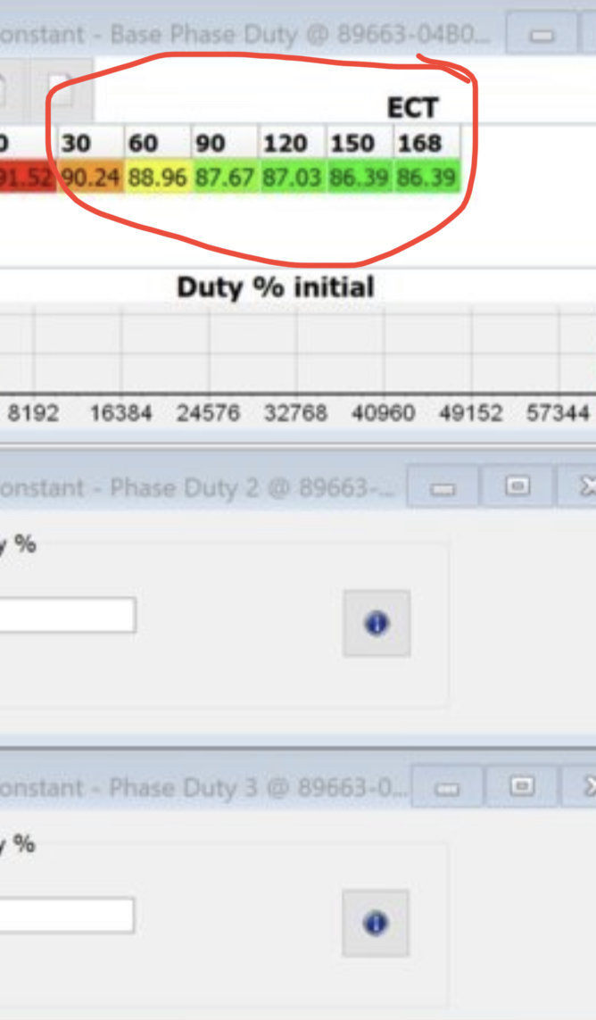

    I changed the Duty % Initial to 93, which wasn't high enough, then changed it to your recommendation of 94 and I'm getting 14.36 max like I said.
    The other ones that Boris didn't have listed (Phase Duty 1 & 10, because he said they didn't need to be changed) I left alone.

    Did you change all 6 of these to 94?

    I changed the entire row to 94.

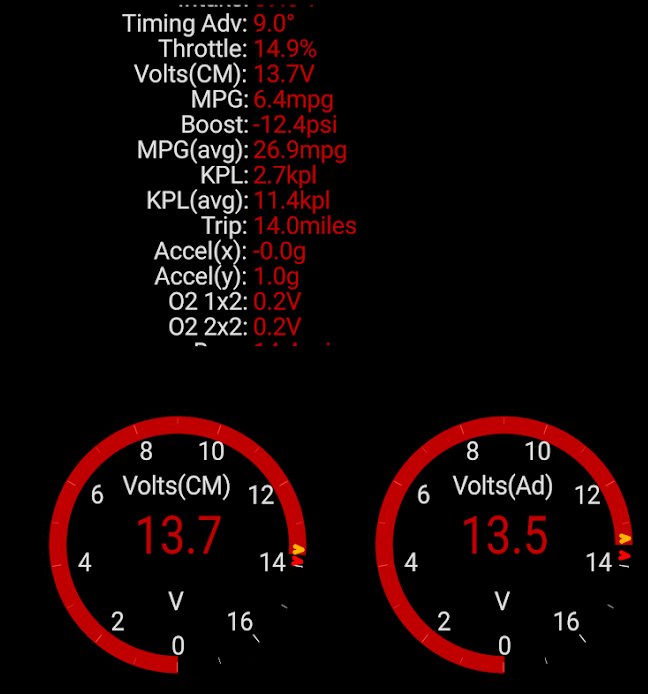

    These were my readings from a 20mi trip. No AGM. I'd say that is roughly 13.5 to 13.9? The Commanded side seems to match the voltage measured at the terminals.
    If the Torque guy ever fixes the app for Android 11, I'll edit the range to see better.

    VMs are great for diagnosing batteries and regulators that are on the way out. A permanently mounted one saved me on my bike when the stock R/R was kicking the bucket.
    The only problem is that there is a voltage drop for anything not connected directly to the battery. That is where my screenshot came from. It is good to know what that drop is, esp when working with the charging side of batteries.
