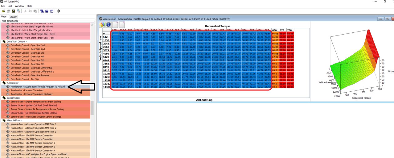

    @OVTune , or anyone who has changed this, could you point us in the right direction for changing the accelerator sensitivity (tip-in) please? TIA

    OVTune
    find this table. and increase values.
    Do not modify the red values that are 89.09
    easy way to mod is highlight area, press * and multiply.
    100 = 1.0
    125 = 1.25
    (for multiplying)

    alternatively, you can mod throttle per individual gear.
    be careful though, it makes a dramatic difference.

    Thank you for the quick response! Where would we go to change it in 4hi and 4 lo if we want to decrease sensitivity?
