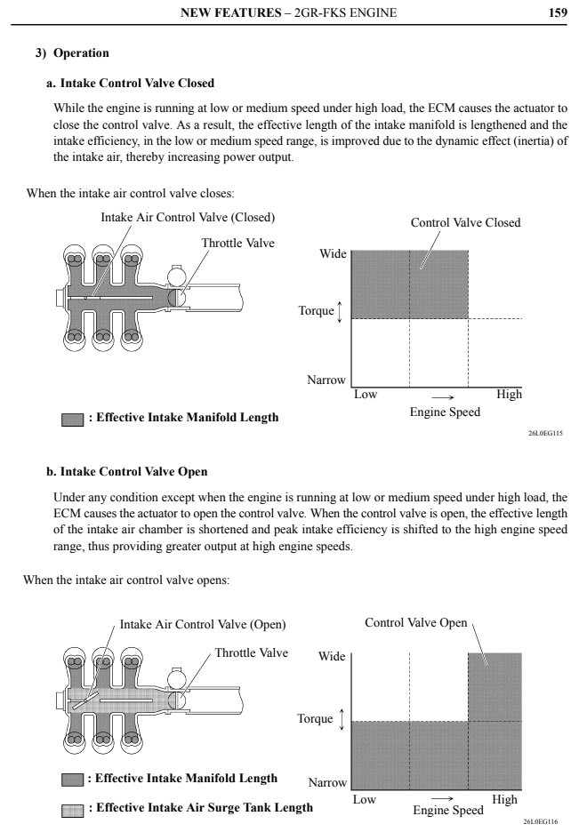

    The way i understand it, short intake is ideal at high rpm, long intake is ideal at low rpm. So there wouldn’t be a good or bad way to move it, but an ideal rpm value for the transition. I don’t think its anything to do with say an efficiency to power toggle.

    You are corrected and I had the default setting wrong. It looks like it would be closed (long) at engine off / low rpm. I assumed that open was the long tract.
    Like you said, maybe it is that opening later is what helps? I know that @RedBeard1 had some good info on this. Possibly keeping it closed in that low RPM / high load region is where the benefit is at?
    Here's is what is noted in the Tacoma Engine pdf:

    on the dyno the best place for ACIS activation was around 3400 rpm.
    activating it later than 3700 creates a large drop in torque.
    activating it below 3000 rpm will bog.
    There is a "sweet spot" range from 3300-3600 rpm.
    however, no matter where it activates there is a momentary torque dip
