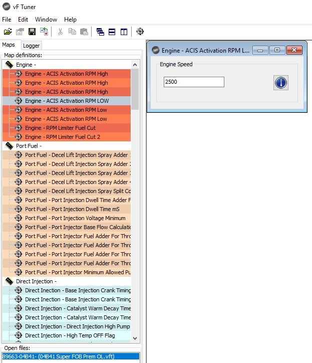

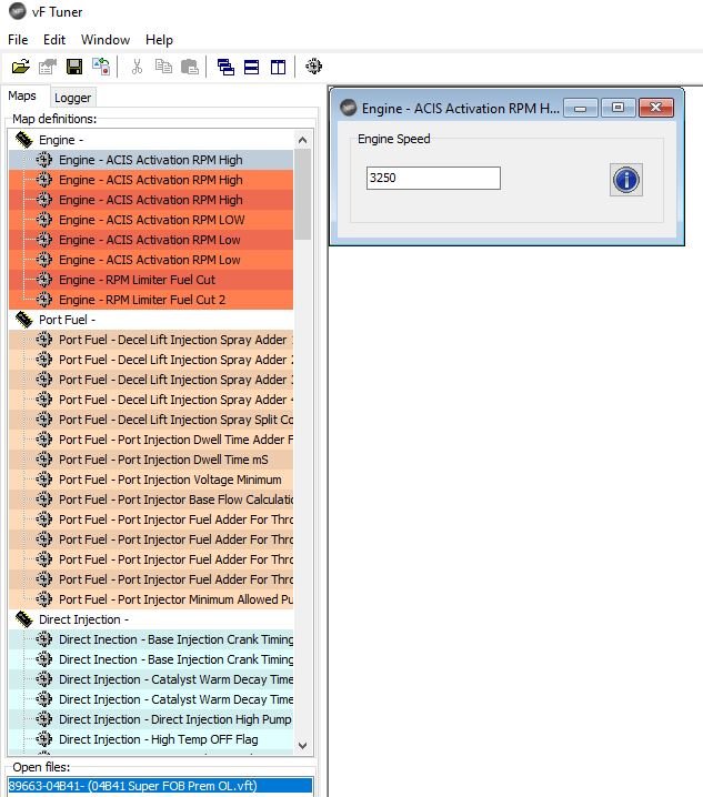

    Ok, this time I'll add pictures..
    @OVTune , can I get a quick lowdown on the high and low settings, and what the fack the breakpoint thing is?

    I was just looking at 04b14 files and the second one you have (ACIS Activation RPM High) I’m seeing a value of 25600.78
    The others show up the same in 04b14
    MOC221_[QUOTED] and tonered like this.

    I just want to know how the low and high settings interact, and what the "breakpoint" does.
    Stock settings are 3650 high and 2700 low.

    I've been looking into this for some time and could not make sense out of it.
    I have 2.0 set to 2700 low ( but there is that weird value 25600.78 for low and high) and 3650 for high.
    But in real live, ACIS activates at 2420-2460 rpms. In some case It would stay opened for 30 sec, causing effect of hang rpms.
