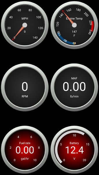

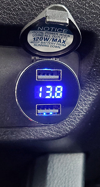

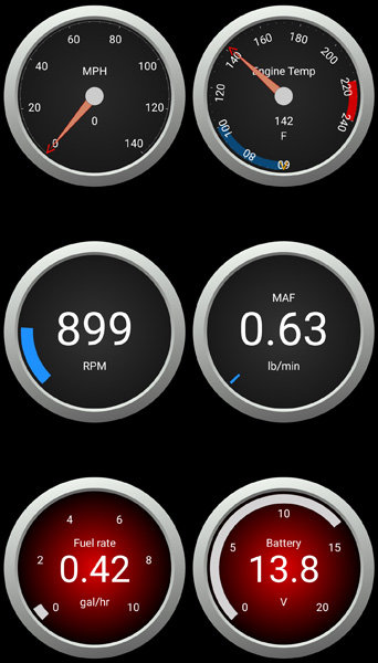

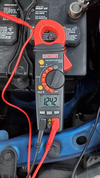

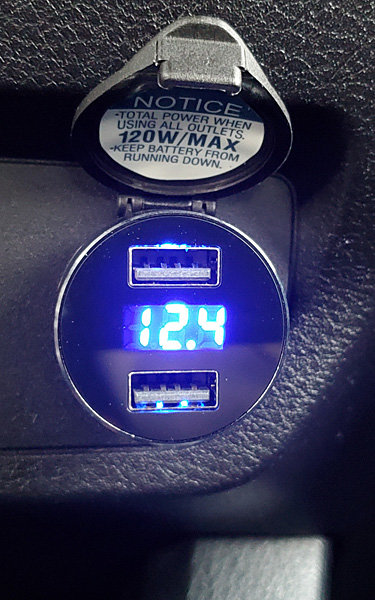

    I always thought of the cigarette lighter socket as being a good source to tap in to the wiring for a voltage gauge, shy of going directly to the battery (which is best). It is on it's own fuse and circuit, usually.
    Today I tested the voltage Key On Engine Off and Key On Engine On. I let it settle for about five minutes in each test.
    Here are the results with a Multi-Meter vs OBD Fusion vs Cigarette Lighter Volt Meter.
    I gave the Multi-Meter an extra digit to the right of the decimal point, if I didn't all readings would have been identical. I usually rely on Fluke Meters. This Craftsman Meter is affordable and I mostly bought it for the High DC Amp Clamp not found in most Multi-Meters, for verifying high loads.
    All said and done this item from Amazon seems to be doing a good job, is very affordable and you can take it easily from car to car (no, I don't have any affiliattion with this product in any way, shape, or form, LOL).

    Key On Engine Off:
    Key On Engine On:
