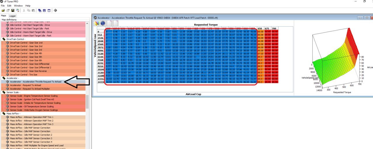

    So what I just changed did nothing? Or is it doing what I think it is... "turning up the pedal commander"? Am I screwing around with the wrong stuff for the outcome I'm looking for? If so, please let me know, I'll just wait for the performance tunes because I CLEARLY HAVE NO IDEA WTF I'M DOING :)

    ok. so now that I started to read through all this thread, i see this... if i already did the individual gears via throttle management... did it affect the accelerator map already? do i have to reset the throttle management to what was in there before i do the accelerator?

    Ok. One more question for tonight. If i modify my VFT tune and save it... can i ever get the original back? redownload the zip file or something? or do i need to record all my changes so i can revert back to what you gave us as a "starter" file.

    Modifying the 2D tables is an effective way to make gear dependent throttle changes.
    We modify the 3D global, that affects in " general "

    Before you start tuning, take the tune you want to tune and “export” it as a different name. Then tweak that file. Then you don’t lose the original.

    So let's say I was to naive to ask that question prior to saving changes... Can I somehow get the original back? If not, I did write the values down. And now I know to export....

    Download it again

    I have the same 04B04 ECU and can send you the original. Let’s leave OV alone to do the heavy lifting. PM me your email and which file you need.

    This also, you should have the original zip file you can go back to.

    S mode and d mode do not have the same per gear throttle limits on the stock tune. So you would need to update s mode to match d mode, then make your changes to d mode, if you really want to be able to compare.
