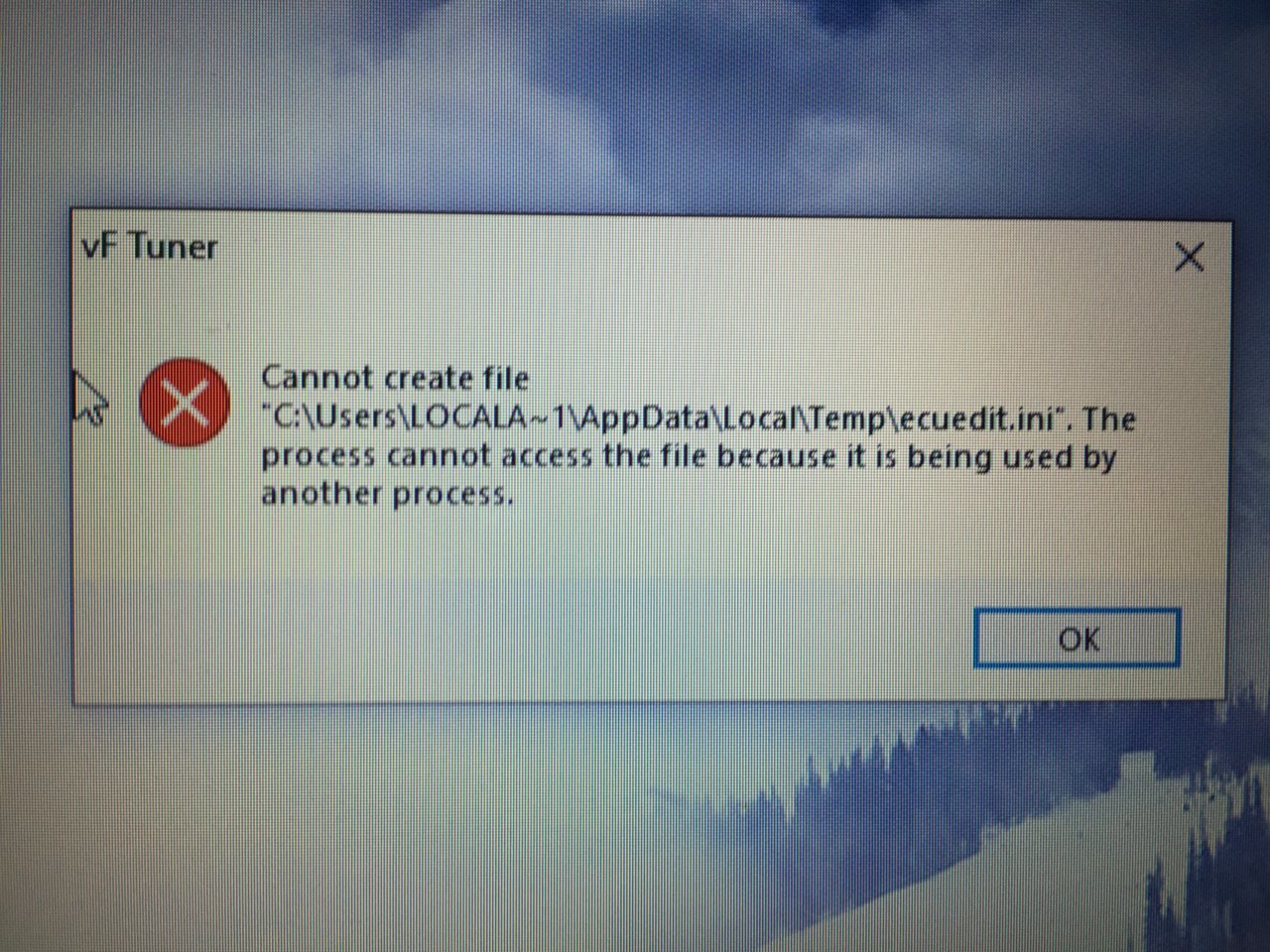

    C4Fab LoPro, BAMF Sliders, Ext ADS 2.5’s, 4.88's, OVTune (OG to KDMax)
    Hey guys I’m confused on what is actually available in the tune packs right now. I’m looking for the exact file I am running now:
    04B04 2.0 91 octane for 4.88’s in the 31-33” tire file. Raphael responded to my zen desk email, but my question wasn’t answered. Is only the stock config a available?

    Just got them. Thank you.
    I’m squared away. Now if I could get VF tuner to work that would be great.
    Thoughts @OVTune ?
