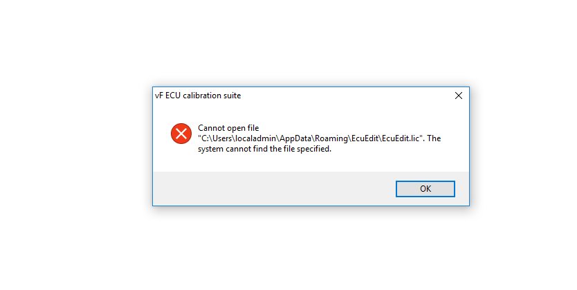

    SpeySquatch
    SpeySquatch Function over Form
    Mar 6, 2018
    #246516
    7,366
    2016 TRD OR DCSB
    C4Fab LoPro, BAMF Sliders, Ext ADS 2.5’s, 4.88's, OVTune (OG to KDMax)
    I can see the file, but it wont load for me. I sent an email to zendesk.FileError.jpg
  20. May 1, 2020 at 6:16 PM
    #380
    TWTaco
    TWTaco Well-Known Member
    Dec 19, 2015
    #172601
    5,967
    Dave
    Did you you look in the This PC Local Disk(C:)
